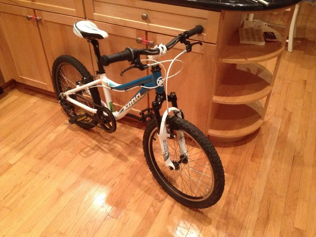

    My 6-year old daughter is rapidly outgrowing her Specialized HotRock 16, so I picked up a 2011 Kona Makena 20" bike for her this weekend ($100 from my sister). Except for the Spinner fork, it seems nice and light, and has 1x6 gearing with linear brakes.
    First upgrade will be a cut-down low-rise bar (the Kona bar is steel) and maybe relacing the front wheel to a QR hub if I can find or trade for a cheap 36h hub. The steel clamp seatpost would be next, then maybe lightening that fork somehow (rigid alloy fork instead with threadless headset?)
    Any other Makena owners out there?
    Thanks - jMJ

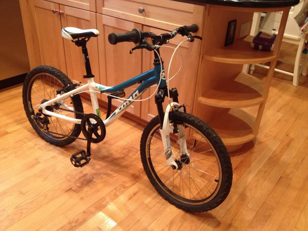

    Finally got around to prepping the bike for Xmas. Took off the steel seatpost, stem , and hbar and installed a Felt carbon post, 1-1/8" alloy quill adapter & 50mm x 10 degree stem, and a cut-down Sun Ringle hbar. Took just over 1 lb off the bike. Adjusted the brakes and shifting, and did a thorough cleaning.
    JMJ
