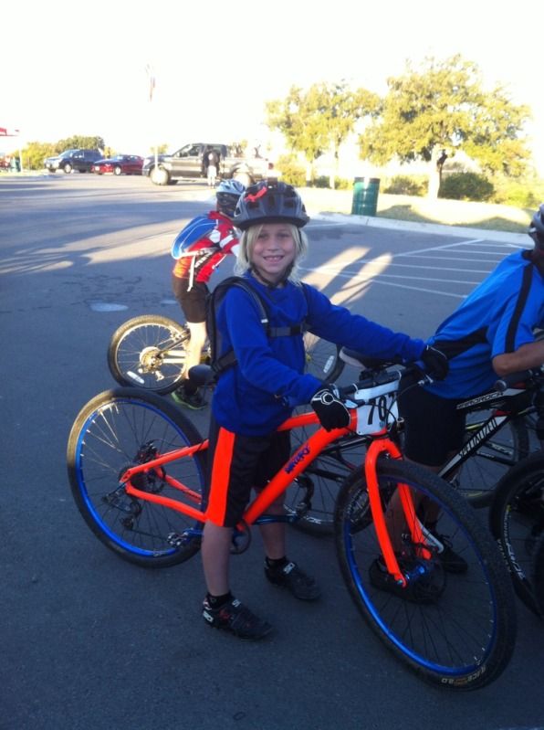

    Here is the build for my 8 yo that I did at the end of 2011 when he was 7yo. 26" wheels are not too big...just have to fit everything else to him. My kid has grown a lot in the last year, but bike still fits.
    Another Performance Access 14.5 build log
    147
    Page 6 post # 149 has a lot of pics and video of his progression into and on 26" wheels

    I know a 10yr old on a xs 26'
    147
    8.5yo on 26"
    1,163
    Quote Originally Posted by wycough View Post
    8.5yo on 26"
    How tall is your kid and inseam? Sure looks to be crotching the tt to me...but if it works!

    147
    Quote Originally Posted by GSJ1973 View Post
    24" inseam on a 25" standover approx.
    based on race results against all older kids in local N. TX mtb series and the urge to ride 2 to 3 times per week, i'd say its working just fine. Now I will say that his bike skills are well developed for an 8year old. He was even on this bike at 7yo. Those bike skill were developed racing bmx over the last 4 years, dirt jumping and mtb on local trails in DFW area.
    7,441
    And this is the only point I keep trying to make. I'm not picking on you but I keep seeing everyone say it will be fine on a bunch of these posts and never go into details about the child it works for to the person asking.
    Now, had your son not been BMXing for 4 years and was just now trying to learn bike skills, would you still consider this bike a good fit or too big?

    I think this post has moved from discussion about younger kids to a little bit older ones now. Original title was for a 6yo. My kid had no issues at 6yo riding a slightly customized bmx bike on the local trails in the Dallas, TX area. The advantages of the bmx bike to me out weighed the mtb options for a 6yo. A basic used bmx mini race bike can be picked up cheap. The light weight of the race bmx allowed my son to develope bike handling skills and attack the trails aggressively. At 44yo, I still ride a SS rigid 29er. (actually just changed it over to a fixed gear) He started riding bmx and trails at 4.5yo
    I didn't build his 26" 1x9 hardtail/rigid fork until after his 7th birthday. I felt he was ready for that bike at that age and size due to his ability learned on a bmx race bike. Some comments lately about the 8-9yo age range. Sure at that age, i think a proper mtb is needed as opposed to a bmx race bike.
    Kiddo just turned 8 this summer, so i'll update with a few pics and video for visual on sizing and skill levels both bmx bike and mtb. He has been riding the 26" now for about 1year. He races local series and consistantly podiums against older kids. The only changes to the 26" has been to raise the seat and switch to longer cranks, but recall i started him at 140mm. Heck, the seat went from slammed to 6" seatpost showing. He has also moved from a mini bmx frame to a jr size for his bmx racing. So he has grown! There are alot of pics and vids below each shows different bike skills and sizing with both bmx and mtb. The decision to chose bmx or mtb at different ages ultimately is an individual choice. We just chose the lighter higher quaility bmx race bike to transition into a 26" mtb. (just click on images that say they are videos to play)
    bmx late 6yo
    mtb early 7yo
    mtb early 7yo video
    mtb 1st race on 26" early 7yo
    bmx late 7yo
    bmx video late 7yo
    mtb today's race 8yo
    mtb today's race video 8yo

    Here is the first part of the post that I referenced that includes info on his 26" build including a parts list and why I chose certain parts...
    My buddy at the local Performance found me a returned Access frame hanging around down in Austin. So they shipped it up. $120 total with shipping. I'll keep up with the build log here.
    My son is 47" and 50lbs 6 years old. He has been racing local MTB scene on a SS Redline BMX(20") geared for local trails at 36x18 on 145mm cranks and running it tubeless with 21x1 3/8ths tires.
    The Access will be just a bit big, but I think he can handle it. If not, it will last a long time so it can just sit and wait. But, I just don't see that happening. Going to do a 1x9(34/11-34) in bright orange and blue anodizing.
    Parts List so far...
    Access 14.5 - wow! nice frame and light. Will powdercoat it next week, I don't like the flat black or the stickers. Gonna shave the v-brake mounts,too.
    Origin 8 Cromo Lite - it's the 396mm A/C at 1120grams. That will lower the front end alot. The curved legs and rake should ease the twitchy-ness. Will shave the v brake mounts also before powder.
    Truvativ 40mm stem/Origin 8 15* flat bars - shortens the reach for him
    Woodman headset and seat clamp - blue ano
    Sun Ringle Equalizers - blue ano...very sweet wheels by the way
    SRAM X7 rear deraileur
    SRAM X9 twist shifter
    SRAM 11/34 Cassette
    Odessey junior seat
    Origin 8 Seatpost
    AC 140mm cranks - blue
    XT Bottom Bracket
    ESI Grips - Blue
    Race King - front 26x2.0
    Small Block 8 - rear 26x1.75
    BB7 Brakes Jagwire housing/cables
    Tektro Mini Levers

    It is a really small bike. I think I had to take into consideration his riding ability, the difficulty level of our local trails and lack of quaility in 24" when making the decision to move him to 26". I think the 26" has improved his skills in the last year among other things. A 24" with big cheap heavy stock tires prob measures very close in size to a 26" with smaller appropiate size lightweight tires. I bet his 1.75 Small Blok 8 has a pretty small overall diameter compared to a common stock brand name 24" bike/wheel. So i am gonna hold true to ready for 26 inch. However i would have been concerned with the standover for a less experienced rider. One should also consider that a higher quality 26" bike will also ride and handle better than alot of generic 24" bikes on the market.
