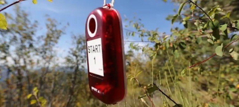

    Does anyone know how the system works that they use for the Trans-Provence?
    From the video it looks like you tap a beacon on your wrist to this and when it beeps your time starts. Any idea on how the finish line works? Timing light or RFID?
    81
    It's called SPORTident and it's made in Germany. Originally it was made for orienteering and apparently really durable and simple to use; racers just swipe the control station with a card at the start and finish of each stage. At the end of the race you can download the time and print off individual results with a special printer they sell. The only reason I haven't pulled the trigger is because I'm trying to find Enduro specific software to go with it so I can manage all the results. Here is the website SPORTident
    I have been looking into this system for the enduro I put on. Capitol Forest Enduro
    1,788
    So these are just basically little RFID writers and they writing a time stamp on the card at the start and end of each special stage. Pretty simple to then read the data after the last stage and compile the days results.

    We have used the SportIdent system for both our events this year. (Home | Endurorama). Overall great system, donwside limited rental avalibility in the States. Purchase price in on the somewhat high side (approx $4000 for equip and up to 170 timing cards).

    In the full $4K kit it looks like you only get 10 control units not including the start and finish, so you could run 5 special stages.
    I recently raced an Enduro day in Whistler that was part of a larger 3 day multi stage event and we had 9 special timed stages strung out over 50km of trail. The flaik gps system was used, there were some teething issues and some racers didn't get any results. To use a system like the Sport Ident for a day like that you would need 18 control units.
    The starter kit at $2k with 1 master and 11 units is much better value if you don't need to have the thermal printer print stubs for the racers. You can run six stages.

    From Adam Craig's blog post. The SportIdent system seems to be well liked by the riders. Adam has done all the Oregon series and it's good to hear a riders opinion on timing.
    Seven days of riding laid out on topo maps with navigational descriptions to lead us on our merry way. Aided by spartan, but sufficient, signage placed by the course marking crew, two lucky guys who rode a day ahead of us, showing the way. We also were given our timing chips. This is the amazing part. To start each Special Stage, you simply wave this card past a Belise, hung from a tree on a ridge some, it beeps, then you give ‘er until you get to a valley, presumably, and careen into the arms of someone holding another Belise, and, beep, you’re done. At the end of the day your chip is handed in and a paper printout of your times is immediately generated. Slick. An amazing system that makes racing multiple daily stages in the middle of nowhere, France, possible. We need this system for North American Enduros. Period.
    Trans Provence 2012- The best riding of your life. | Adam Craig

    We ended up purchasing a SportIdent system and very glad we did.
    James at SportIdent put together a custom kit for us. Control units to run 3 stages and 100 cards for racers. So far we've run four great events of our six race series. These are "Toonie" races on Thursday nights, racers need to be a member of the NSMBA ($40/yr) and then it costs them just $2 to race. Our turns outs have been, 83, 76, 78, and 68. This is a HUGE jump from our previous XC/AM single lap races we had last year that struggled to get 6-10 racers.
    We run a custom excel sheet for results. At sign in we allocate the cards numbers to the racers, this is the only manual part. As racers return their times are scanned in using the free software SI-Config. Some simple functions and a Vlookup function gives us results. I can generally run them in 10 minutes after the last racer has arrived in at the finish.
    Next stage is to actually run the scan times directly into a mysql database and have our website crunch the results live as people arrive. The spot where we host the race has really bad cell phone reception so I have not been overly motivated to complete this, we just got access to a high power cellular modem so this week we'll try the live timing.

    This just turned up in the mail
    Attached Thumbnails Attached Thumbnails Enduro: Timing systems and timing formats-image.jpg
