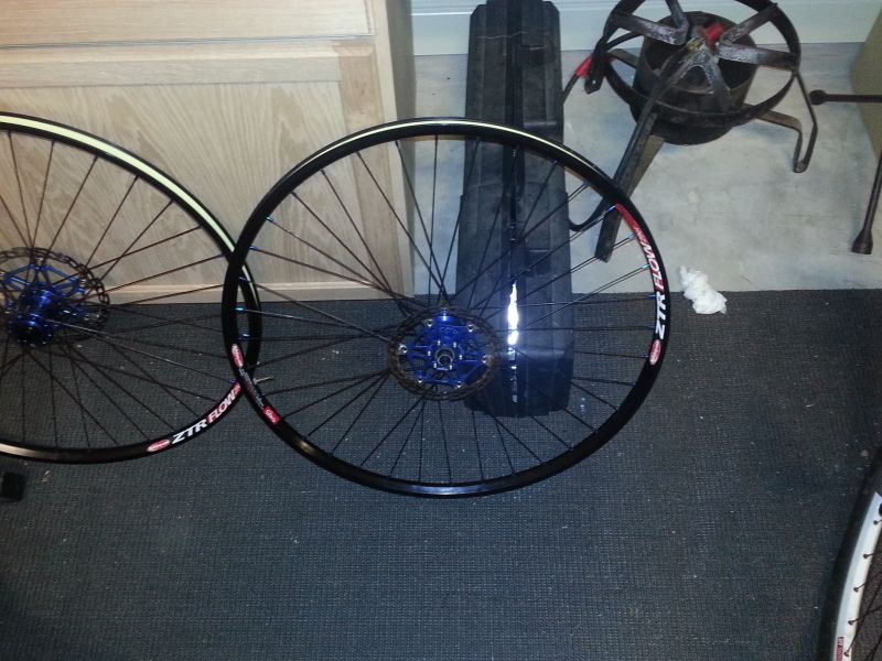

    Already have the rims built, need to buy the fork and some other odds and ends.

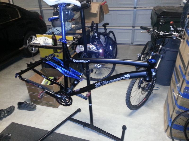

    I apologize for the cell phone pics.
    1.5 degree angleset, raaaaaaaaked out like a chooper hehe.

    Just rode!!! Its awesome so far. A lil squirly when doing a jump but its a bit more efficient going uphill. Ive never been an uphill fan though. Dunno if im sold on 29er just yet. The bike is solid though, great feel to it and a definite head turner.
    2013 Ibis Mojo HD Special Blend with dropper post, hope/stans wheelset and hope x2/m4 brakes
    177
    To avoid that squirely feeling try a shorter stem. I'm running a 75mm and mine tracks really well. These frames have long top tubes and are designed for shorter stems to keep your weight in the right place.
    301
    I wonder if anyone else out there has an angleset on their evo and 1.5* offset with a 140mm fork.. bet i'm the only one
    177
    Not an angleset but I have some offset bushings, well only the top, fitting both results in the rear tire (Ardent 2.25) hitting the seat tube. I wish the HA was closer to 70* on the Evolution! Can't say I can feel much of a difference.
