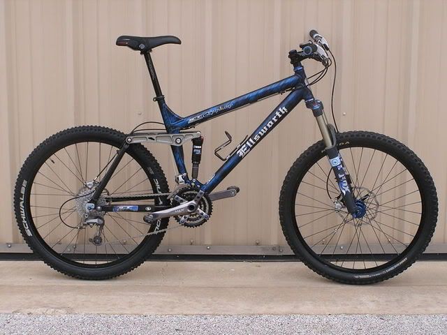

    I have been tinking with my 07 Talas fork with different settings and feel that I am still searching for that sweet spot for handling corners and flowing singletrack.
    At 140mm I feel as if the bike is a little high up (I like running my rear suspension a bit stiff for more pedaling efficiency) and can be a bit tricky on steep downside switchbacks. At 120mm the bike rolls the singletrack with precision, if not a bit of oversteer. In that mode, if I don't that the fork locked out or with a high air pressure, the fork can dive in rougher stuff and I sometimes get some washout. The steering gets sketchy of course due to the steep HA.
    So, I am wondering about those who have an Epi with a 130mm travel fork and what they may have experienced with their setups. Any info would be appreciated.

    You also need to take in effect your riser bar, headset spacers and stem length/rise. Those things also greatly affect your bikes handling. Do you have a picture of said Epi? If not, can you give the stats on the equipment I listed? Oh yeah, tires can also play a part. The taller tire designs will be felt in the handling too.
    My setup is a 90mm x 10* stem with a 20mm spacer underneath it. I have a low rise bar on it.

    I realized something yesterday regarding this problem. My handlebar was about 2.5 inches below my saddle.( I recently increased my saddle position higher to maximize pedaling). Well, I added another 20mm spacer below my existing stem stack and took it for a test ride. This solved ALOT of my problems with fork dive and handling. I was able to keep it in 120mm mode and was able to rip up the trail with alot of control. Oversteer was gone due to less weight on the front end. My riding position is higher and I am more comfy, but I am also faster due to the handling being right on. I just settled in behind the saddle on downhill turns and it just stuck the turns without any real attention to body positon.
    I can't believe how such a little change could go a long way, I also reduced my preload on the Fox Fork from 90psi to 75psi due to me previously combating fork dive and that improved the handling even more!!
    Thanks a ton for all of the info on this. Hopefully, I can dial this in even more, but for now it is SOOO much better.
