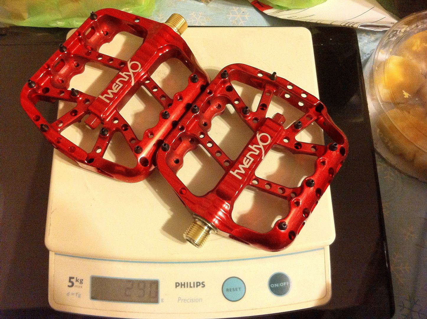

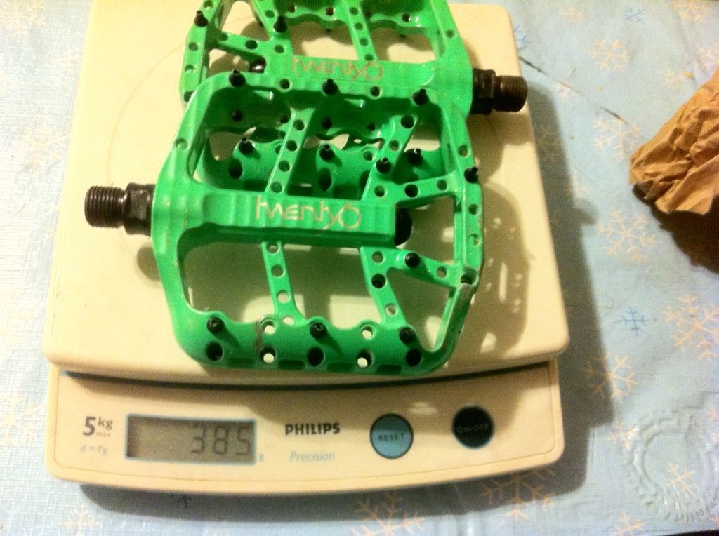

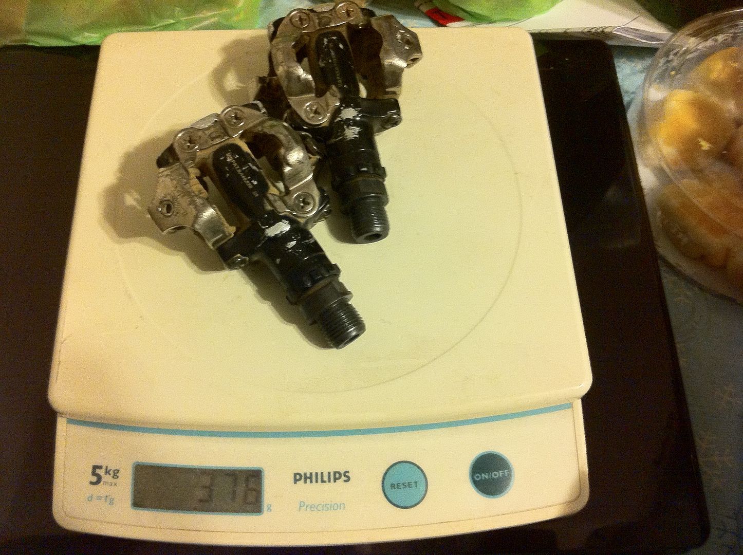

    My Twenty6 platform pedal is 290g actual VS most platform pedal at 530g+

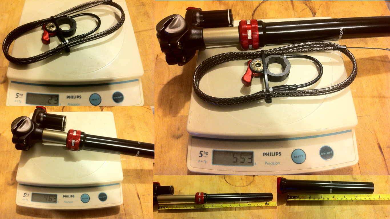

    As for the adj seatpost, there's a new kid in town, now for 27.2mm you can get Hydro post. KS i7r, it's 553g actual weight 4" drop which should be plenty for the moment, as I doubt that you can drop 9" on the Mamba.
    That's more than 2lbs already. I don't see other option that would be useful saddle, bars, and smaller stuff would ended up costing you a lot with little weight loss.
    Prerunner ti spindle.
    This is a cromo version of the Prerunner version I got this one as a demo from Twenty6 with new bearing instead of bushing, it weight about the same as the Shimano 520

    Those pedals look sweet. How wide is the platform. I find my V8's too small for my size 12US (UK 10.5) 5.10's so was looking for something new, I like the look of the Vault with a ti axle which is just over 300g.
    I like that post but I need layback which is why I went for the RASE in the first place. The 9 inch drop is rarely needed (occasionally very useful though) about 5 would be perfect. I am looking at the Gravity Dropper with an Ibeam mount and saddle. It is the lightest dropper post set up available.
