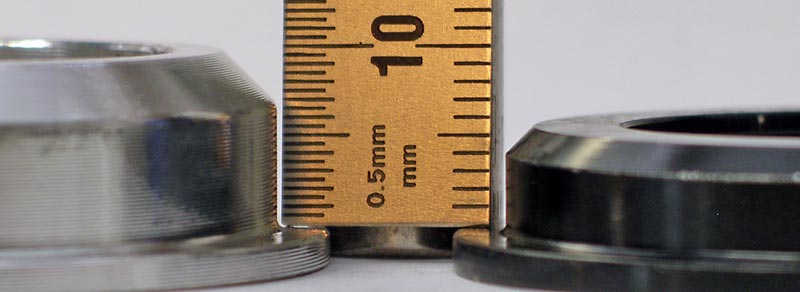

    Realizing this thread is a month old, I'll offer up the following info on the NRS:
    Yes, it used a Zero Stack headset system.
    The cups are removeable, just like conventional headset cups. If they weren't, it would be obvious the head tube is a solid chunk of aluminum. Next time you're at the shop, take a look at an Ibis Mojo or a Maverick frame, or any number of road frames to see the difference.
    If you have a frame earlier than 2002, you'll need a shallow Zero Stack headset, which conforms to the original Cane Creek standard. Compatible headsets include the entire Cane Creek ZS line, as well as the FSA Orbit <b>ZS</b>.
    Newer than 2002, Giant began reaming their head tube deeper to accept deeper cups. An example of this is the FSA Orbit <b>Z</b>.
    I've posted pictures of the two cup depths below.
    As a commentary, it is unfortunate the "Integrated" (i.e. machined head tube, drop-in bearings, no cups) is so similar in name to "Internal", (aka Zero Stack, w/ pressed-in cups).
    Zero Stack is by far a superior design to "Integrated," yet despite the problems/complaints/rants against the machined-in design of the Integrated system, Giant <i>mistakenly</i> continued to refer to their headsets as "Integrated" on their website for a number of years, adding to the confusion.
    Then FSA goes and modifies the standard (the deeper cups was a change), making them incompatible with some frames, such as the '01 NRS. Last I checked, Cane Creek was still only producing the shorter cups.
    <img src="http://www.booboodog.net/images/orbitz-zs2-cup-compare.jpg">
