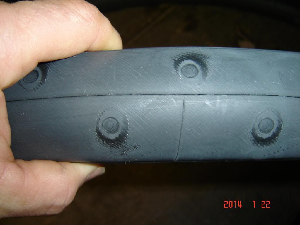

    In the late 90s I made a set for my FR bike with nuts on the outside to stabilize the screws, which made for 'studs' so huge I basically needed to get off the bike and walk it over bare pavement. But the traction on icy downhills was hard to argue with, especially with the 15km+ loop route in south Scarborough that involves almost no bare pavement at all. Where I live now they'd be of no use.
    Are these being set up tubeless or with some kind of tire liner? Before the dawn of Stan's, I had repeated problems with even low-profile screw heads rubbing through all kids of tape and improvised liners and flatting the tube.
    I suppose a thick piece of another tire would have worked, but the tires were getting ridiculously heavy even with only duct tape in them.

    Hmm, I never thought of the screws rubbing through. I didn't put anything in between. Maybe I can glue some self amalgamating tape around the inside of the tires if it becomes a problem.
    Thanks for the heads up.

    You'll definitely want to add a liner, sooner rather than later.
    Even with all of the extra holes, I wouldn't be surprised if tubeless would still work. You might just need extra sealant, and more time to let it seal up. The one problem I had with tubeless was that the screws on the rear tire started to get pushed back into the tire:
    So I took them all out, gooped them up with contact cement, and that seemed to work okay.

    So the tube isn't going to work for me? I'm not set up for tubeless and don't plan to be any time soon. Not with this bike anyway.

    Thanks guys, you probably saved me buying a bunch of tubes.
    I thought I had revolutionized studding by buying rounded screws.
    Here's a new tube I threw in the rear tire yesterday after pinch flatting half way through my ride. (think I pinched only because I was low due to a pinhole likely because of the screws now)
    I taped up a few layers of duct tape and threw the same tubes in and I'll just hope for the best.

    Ok so to update.
    After learning the screws were damaging the tubes I threw 2 layers of duct tape on each tire and I pulled off almost 100km over about 6-8 rides on the ice trails and pulled the tires to inspect today.
    The tape had wore pretty much through and I may not have gone much farther before flatting.
    I decided to go with the heavier more reliable solution of splitting a tube for a barrier.
    How heavy did it end up? (weight weenies please leave the room)
    Studded tire 855g
    Complete wheel without rubber 1232g (stock Giant SXC-2)
    2 tubes>400g
    2487g Front tire studded and installed. (never weighed rear)
    All in all I love these things. Saved a bunch of money over the the $400 pair while having fun screwing around in the workshop. Screws+tubes+tires+band-aids, under $35 each wheel.
    I've been able to make great use of the local paved (iced over) paths which are plentiful around here and even ripped around on the frozen bay where I also went Ice fishing this weekend.
    Thanks for all the help and advice.
