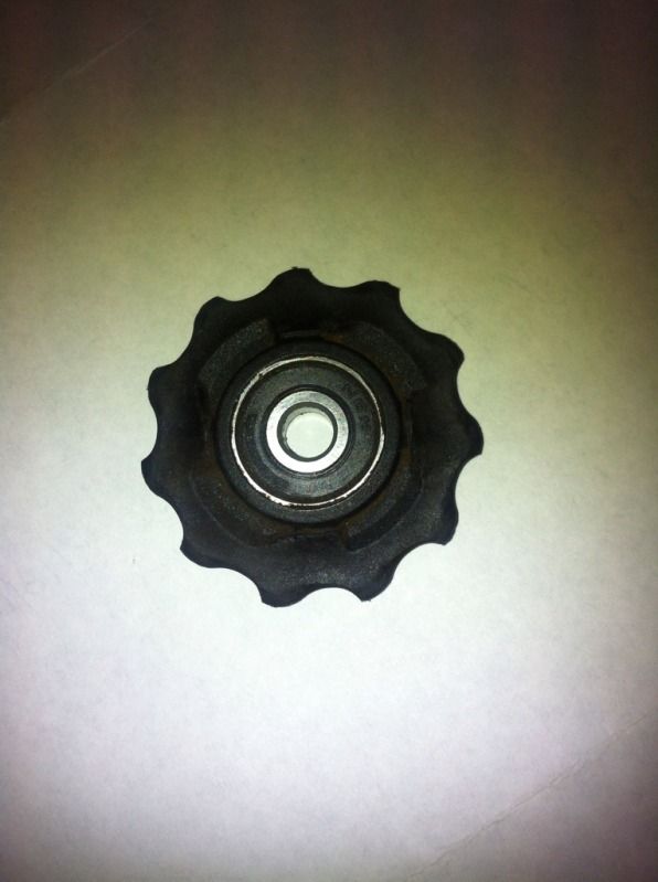

    x.9 type 2 derailleur problems
    Hey guys i installed my SRAM x.9 rear derailleur type 2 with all new 10 speed gear cassette 11-36, chain, and front 34T ring i was having trouble after about a month on the new setup i noticed that there was a strange noise coming from the bike while pedals in the low gear when i put the bike was in the stand i noticed that it was also having a hard time dropped from the low gear (36) to the next gear down, its also having trouble dropping down from the second to last high gear to the highest gear (11) cable tension would help a little but the B screw seemed to help the most but i could never get it perfect and today after pulling the chain i noticed the top pulley was completely worn out already! does anyone have some insight on this?
    derailleur to close to cassette?
    chain line issue?
    to much tension from type 2 system?

    Don't know anything about type two's, but that derailleur looks way too folded forward and stretched out for being on the big ring in back. Chain too short?
    edit* after looking at the photo again, something seems totally screwed up. To me the hangar even looks funny and the upper jockey wheel is waay too close to the cassette.

    Quote Originally Posted by ghettocop View Post
    edit* after looking at the photo again, something seems totally screwed up. To me the hangar even looks funny and the upper jockey wheel is way too close to the cassette.
    actually it looks too far away or just about right.. it should be around 6mm tooth of cassette to tooth of jockey wheel unless they changed that with the new clutch units
    the way that jockey wheel is worn it looks to me that the hanger is slightly bent (if you notice the angle worn into the side of the tooth it says the chain is sliding off the side not off just the top) Also having the B screw set too far away the top edge of the jockey wheel tooth will wear in a "shark fin" like that because the chain isn't leaving the wheel smoothly and is using less of them to guide the chain onto the cassette.. closer to the cassette give the chain more wrap around the jockey, more teeth doing the same job..
    the chain does look a tad short ... with a guide like that the chain should have at least 2-4 extra links..

    Quote Originally Posted by thomllama View Post
    The chain is the correct length it is 1091 with one link removed on my santa cruz nomad.
    As for the b screw it probably is not adjusted correctly in the photo. I had been adjusting in and out after i was pretty fed up trying to figure out if that indeed was the issue with the derailleur not shifting correctly.

    hmmm can't really tell much that far away from the drive train..
    does look like the B screw is WAY tooo far out but again, hard to tell... can't really even see what the issue is if the Shimmy stuff is working.. leave it
