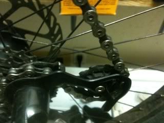

    What makes this happine
    <a href="http://s93.photobucket.com/albums/l45/ae111black/?action=view&current=fb137db8.jpg" target="_blank"><img src="http://i93.photobucket.com/albums/l45/ae111black/fb137db8.jpg" border="0" alt="Photobucket Pictures, Images and Photos" /></a>
    I did a small drop about 2' and this happined... Bizzar! Never seen this before can't figure out why!?

    Possibly your chain is too short and you cross chained big/big and it yanked the chain out of the rear der cage.
    Need more info. Full suspension?
    How did you size the chain?
    What length der cage?
    Triple crank?

    ok cannondale prophet, sized big to big + two links, short cage x9, double crank 36-22 slx
    I assume that I have every thing right..... At the moment I was in big-ring small cog....

    The picture isn't great, but it looks like the halves of the derailleur separated. If that's the case it was probably caused by a loose bolt on the jockey wheels: have you played around with them recently?

    Nope the rear duerilluer is quite new and I checked the jockey wheel bolt and it was factory tight.

    Weird.
    The only other time I saw this was someone had a road bike with Dura Ace 7900, upgraded the cassette from 12-23 to a 12-28 without changing the chain. Needless to say the chain was too short. He shifted into big big and the chain did that exact same thing.
    You said it is a short cage? Not a medium?
    Did you size the chain with the suspension compressed?
    If not, then there is a good chance that when you compress the suspension the chain growth could pull the chain out of the back of the derailluer.
    The Prophet is a high single pivot design. If I remember correctly, when I installed the chain on my buddies prophet, we needed a bit more chain length due to chain growth when the suspension is compressed.
    Having the short cage with a 36t chainring, combined with the fact that the suspension design is more prone to chain growth, you may need to go with a medium cage derailleur....or a smaller front ring.
    Either way, I'd start with a longer chain and take it from there.

    I had to compensate for chain growth and gave it an extra link or two when I sized the chain I had to do it after I initially set it up. It took me a while to get it correct ( b screw ect) I'll try the drop again and see what happens I might need another link in the chain!

    FWIW , add another link before anymore drops , less damage .
    Nov 2008
    1,498
    Certainly double check your chain length, and make sure it's correct throughout the swing arm's travel range. Often a chain that seems OK might be too short when the swing arm is flexed all the way.
    It would help if you remembered which gear you were in and whether pedaling or coasting through the drop, If in a mid to larger gear and pedaling at the time it might have been a "B" screw adjustment.
    Check the jockey wheel position on all the mid and larger sprockets and all the chainrings you use with them. There should be one to two links of free chain between the jockey wheel and the sprocket. If not, the jockey wheel can engage the sprocket through the chain, and snag pushing the RD back with goodly force.

    Seems really obvious to me that you mis-routed the chain through the deraillleur cage (although that picture is SO bad, that it is hard to see anything more than it is a rear wheel).
    If you pulled the chain hard enough to pull it out of the cage (you would actually have to pull the chain back and out to the side for this to happen), the cage would be bent badly, and either the B nuckle would break, or the hanger would be BADLY twisted. I short-chained a similar set-up when I first switched to SRAM (they lack the forward B-nuckle movement of the Shimano) and went thourgh a G-out in ~big/big and the result was VERY different that what (I think) is shown.
    2 X 9 with a short cage (on a FS) is just tempting fate.

    +1 to what Dave said....looks like you mis-routed the chain through the der on install.

    Unless the der plates separated on the landing (and OP has already said the bolts were/are tight - that is they did not separate) there is no way the chain could end up on the outside of the cage like that unless it was originally, accidentally routed outside the little tab on the bottom of the plates/cage.

    Were you guys being funny about me routing the chain wrong..... ?
    For what's it worth I stated I was running in the 36 chainring up front and small cog in the back when I did the drop as I stated before if you read my post #2 I gave the bike an extra 2 links + 2 extra to compensate for chain growth. I'll add a few more links than try the drop again later.

    I thought the chain was routed incorrecly too. I didn't want to post because I was giving you the benefit of the doubt, maybe the picture was tricking me. Don't want to imply you routed the chain wrong, but it's either that or you need to post a better pic.
    794
    If the lower pulley bolt is still intact and tight as you indicated, than the ONLY way a chain could end up where it is in your picture is if is was not correctly routed through the lower pulley when the der/chain was installed. Unless the pulley bolt magically broke, popped the chain out, then magically refixed itself on your landing....

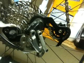

    <a href="http://s93.photobucket.com/albums/l45/ae111black/?action=view&current=c6313ec1.jpg" target="_blank"><img src="http://i93.photobucket.com/albums/l45/ae111black/c6313ec1.jpg" border="0" alt="Photobucket Pictures, Images and Photos" /></a>
    <a href="http://s93.photobucket.com/albums/l45/ae111black/?action=view&current=62ae5af9.jpg" target="_blank"><img src="http://i93.photobucket.com/albums/l45/ae111black/62ae5af9.jpg" border="0" alt="Photobucket Pictures, Images and Photos" /></a>
    here's a few pics as requested of the offending X9
    as you can see it's still in one piece and after I loosened the screw that holds the jockey wheel and re-routed the chain everything is alright!

    Surely if you were in the big-little, chain length is not an issue. If you were in the big-big then maybe?

    I know. The cage is two roughly parallel plates that are connected at each end with a through bolt. When both bolts are in place, the chain can not get in or out of the cage because there is no opening. If both bolts were in place as OP indicated, and the chain was outside of the lower part of the cage as shown in the pic, there is only one way it got there, and that was to start outside the chain.

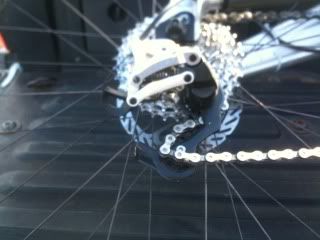

    But I've been riding for a while on this set up...... A few months, even a 17 mile single track indurance race! I think I'd notice a wrongly threaded chain. I'll post the pic of my durilleur from my old thread "90$ down the drain" that's right after I set the bike up
    here's the pic
    <a href="http://s93.photobucket.com/albums/l45/ae111black/?action=view&current=1260725739.jpg" target="_blank"><img src="http://i93.photobucket.com/albums/l45/ae111black/1260725739.jpg" border="0" alt="Photobucket Pictures, Images and Photos" /></a>

    Reputation: tonyxcom's Avatar
    227
    Quote Originally Posted by apat13
    Dont be so sure about that.
    The aluminum plate is the one that has the 90' bend on the end. The carbon plate is flat. I was just able to press the carbon plate with my finger and make the 2mm gap between the 90' bend and cabon plate about 2mm bigger.
    IMO, it is certainly possible that the chain can be ripped through that opening, flexing the carbon plate enough to do so.

    That is not an XO, it is an X9 so only one side of the cage is 'carbon'. The only way a drivetrain can apply force to a chain is in a forward direction (toward the cranks) If chain was pulled forward, it would be pulled against the lower pulley (force direction would lye very near within the plane of the pulley, holding the chain tight to the pulley) and it can only be pulled in this forward direction.
    There is no way for a chain to 'push' back out/off the pulley. The only way for this to happen, is for the torque created by the slightly offset force vector to twist the cage 90 + degrees such that the same forward chain pull force was directed to pull the chain out of the side (now facing forward) of the cage. This sort of rotation would completely destroy the derailleur or mount.

    It should take more than just loosening the pulley bolt to get the chain back inside the cage. I have always needed to remove the bolt and pulley completely and sometimes loosen the top pulley bolt. I would bet the retaining tabs on the cage are bent/damaged.

    Quote Originally Posted by shiggy
    sorry Shiggy I wasn't clearer, that's what I accually meant (removed the bolt) then replaced it.
    The most important thing is what God thinks about it. He will have the final say.” – Joshua Stinebrink
    ____
    Kimo
    I Have Cookies
    Reputation: ae111black's Avatar
    Dec 2008
    2,644
    Quote Originally Posted by AlexRandall
    Chain too short......derailleur cage too short as well
    So Alex in your opinion who's allowed to run these "too short" dιrailleurs? It's certanly helped me from piciking up sticks on the trail..... And in the 90's I always ran short cage xt's with no problem?
    ____
    Kimo
    Mar 2005
    2,029
    Quote Originally Posted by ae111black
    XTs do not come in short cage, they come in long(sgs) or medium(gs). What you have now is a true short cage derailleur, a size that is generally made for road cycling (the reason that most shimano MTB units do not come in short(ss)).
    A few years ago, SRAM was smart enough to see that DH racers were running short cage road derailleurs (something that SRAM did not make) and they added the short X9 and X0 for that market. The newest version of Saint finally added a short cage for the same reason...prior to this, the only way to get a short shimano deraileur was to buy a road part. You were running a meduim cage XT.
    The max cog, and chain take-up specs (difference in big-big and small-small) are all clearly stated on your derailleur manual, as well as on the mfg sites. You would also want to add in a tooth or two (or more on a high forward (virtual or otherwise)pivot bike) in the take up for a full suspension frame.

    LAst summer I removed the big ring and went to 22/32 rings with guard and shortened the chain to have minimal slack in deep travel on my FS bike. It's clear that the long cage always has the most tension since the chain can't be any shorter to use the big/big sprockets. Shorter cages may save a few grams, but at the cost of weaker chain tension.
    ~Disc~Golf~
    Reputation: highdelll's Avatar
    16,492
    forget it dood, at least ya got it back in shape.
    I can imagine a 'perfect storm' where that kinda thing happens -
    I still say tho that I have been routing it this way for years and have never experienced your 'event' - preventative measure?
    Honestly... ahh I give up

    Quote Originally Posted by davep
    well what is this? I've had it for 13 years it has not been used in 11....
    <a href="http://s93.photobucket.com/albums/l45/ae111black/?action=view&current=711dd356.jpg" target="_blank"><img src="http://i93.photobucket.com/albums/l45/ae111black/711dd356.jpg" border="0" alt="Photobucket Pictures, Images and Photos" /></a>
    it's next to a mangled X9 long cage
