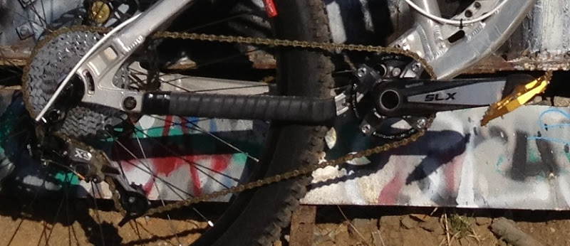

    Reputation: dynamicz's Avatar
    161
    KRob, been following your thread and issues. I JUST build up my Chilcotin this weekend and had the same issues. Like you I do my own wrenching, to a certain extent of course, but regardless I consider myself handy with bike stuff.
    I go a new X9 Type 2 mid cage and did the initial L/H adjustments without tensioning the cable yet. After I was happy with that, did the B tension screw... like you, noticed that with the screw backed all the way out I still have 10-12mm from the jockey to the 36t of the cassette. This bugged the crap out of me too... after an hour looking through photos in google images, noticed that SRAM exhibited this moreso than the Shimano rear derailleurs.
    Now I figured this wasn't too much of an issue but on the stand and rotating through the gears (1x10) I realized the rear chain drop in the low gears is slow or hung up.. immediately thought it was a rear hanger issue. Took it to a shop since I don't have the tool and the hanger was realigned since it was pushed inward 1-1.5mm toward the spokes.
    The bike shifts much better now but I do noticed that the shifting in the low range is still a bit slow... I contribute it to 2 things... the gap between the jockey wheel and cassette and/or going from short cage to mid cage.
    Hope this helps. Maybe you can hit up Dusty for his opinion as well. If you can share with us, that would be great as well.
    Good luck.
    161
    Tried to crop the only photo I had but you can see the gap on the largest cog, B-tension screw all the way out.
    Reputation: KRob's Avatar
    11,857
    Quote Originally Posted by dynamicz View Post
    According to SRAM as quoted by thomllama , 12mm is the new 6mm for 10 speed cassettes (Can anyone else confirm that?). My gap is bigger than that at 15-18mm.
    But with the hanger alignment fixing your problem (mostly) I'm doubly suspicious about the hanger now.
    Thanks. Anyone else with Chilcotin frames and SRAM 10 speed derailleurs notice that gap being bigger than recommended? And does it seem to affect your shifting?

    Quote Originally Posted by KRob View Post
    from their manual... (I clipped it off before opps my bad) notice the "*" star after the 6mm and the list of 12mm's after...
    got to say, that hanger looks like it's in a weird position compared to most bikes.... too low and/or far forward..? just a guess/opinion form the pic thou...

    was curious,.. did a little research on the frame.. One thing I did notice it it looks to have a serious chain growth during suspension travel.. might want to add a link or 2 to the chain (probably not your issue thou)
    the bike is spec-d with that derailleur,.. maybe call the manufacture of the frame and chat with them about the issue as it's basically the frame/hanger mounting that is causing the space of the B screw adj... See if they just don't care? if they have other issues... if there is some reason it's designed that way?
