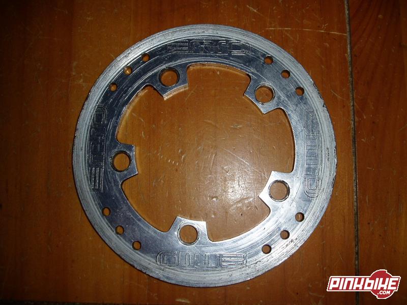

    Yes. I do see many options for 94BCD chainguard/bashrings. However, most of the ones I've seen, including your suggested RaceFace ones, have a cutout area between two crankbolts.
    Many of them look to be for five spider cranks with the arm positioned between two crankbolts as opposed to the hidden fifth design on the Sugino on my bike.
    I've seen a few chainguard/bashrings that appear to adhere to the requirements of the crank design of my cranks, but they don't say if they're meant to mount on the outside of the big ring, or are meant to replace the big ring.
    Assuming this has a 94BCD, would something like this work for my requirements?
    Do you or anyone else have any suggestions for the latter? In keeping with my requirements, of course.
