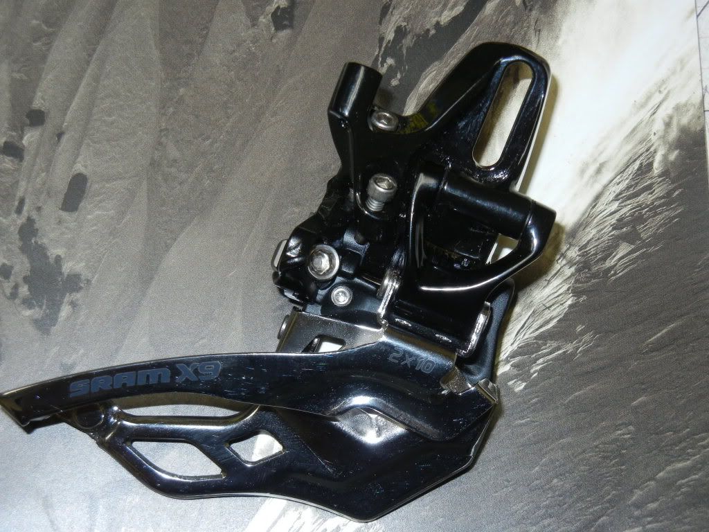

    The 2x f der is made for smaller diameter rings (I believe 36T is the biggest you can use). The cage radius is noticeably smaller than a 3x so it will wrap around the smaller rings better.
    The best part, however, is this; Sram came up with a great new design for their direct mount f derailleur. The cable stop is actually part of the derailleur itself:
    You can see the cable stop sticking up just to the left of the limit screws.
    This puts all the stress from shifting into the derailleur itself. There's no pulling from the frame to the derailleur and no cable angle problems. You just run the cable housing all the way to the derailleur. This also make setup even easier since derailleur placement is independent of cable pull.
    The fly in the ointment? Sram only does this with their direct mount f derailleurs, not on the clamp mounts. Yea it sucks because you don't have a direct mount frame, right? Neither do I.

    That's the part I hope to get in today.
    This should make a killer, super-easy-to-set-up front 2x system.
    All adjustments are completely independent of each other.
