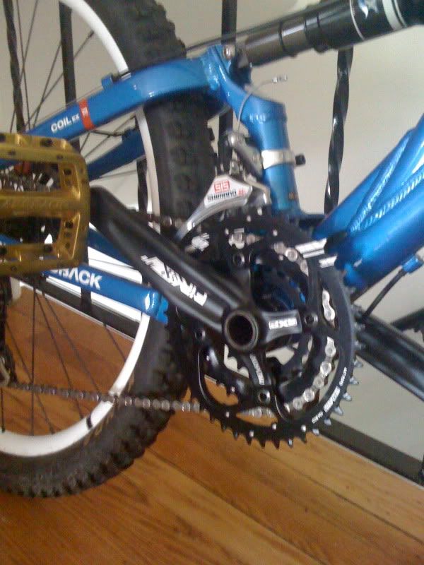

    I recently bought a Truvativ GXP crankset for my bike, and althought it's a huge upgrade, it threw the rest of my drivetrain off. There seems to be a lot of unnecessary friction on the cassette and rear derailleur. Anyway, the only thing I haven't replaced on my bike would be the f & r derailleur, cassette, and seat/seatpost. Can someone tell me what derailleurs would work with this crankset and what size cassette as well. Thank you in advance.

    Probably just need to adjust your front derailleur, maybe the rear as well. Try here http://www.parktool.com/repair/byregion.asp?catid=53. What was your old crank setup? Should be able to use just about any cassette and derailleurs you want to, with the limitations set by your shifters (not your crankset). How worn is the chain? The cassette? Time to change them out or just itching to spend money?

    "There seems to be a lot of unnecessary friction on the cassette and rear derailleur."
    Sounds to me like a chain length issue. Does the new crankset have larger/smaller chainrings?
    I bet all you need is a new chain adjusted to the correct length.
    Looking at the picture of the rear derailleur, it looks like it might need the B-tension screw adjusted as well. But it's hard to tell and probably not what you're complaining about.
    Cassette and rear derailleur doesn't really matter, especially if it was working fine before you changed the crank. You determine the number of teeth on the cassette cogs based on the gearing you want/need, in conjunction with the chainrings.
    Front derailleur could be an issue - look up the number of chainring tooth difference specification and compare to your cranks chainrings - but probably not. And again wouldn't explain the issue you describe.
    So probably a chain length problem.
    Just curious, who installed the crank?

    Before we go there, why don't you explain in more detail what "There seems to be a lot of unnecessary friction on the cassette and rear derailleur" means.
    It also might be helpful if you took some pictures of what you're trying to describe. This way we can better understand the problem.
    Or, the other option is just take it back to the LBS and have them fix it - which would probably be the quickest, least headache for you...
