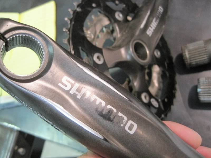

    please help. I tried search and I failed.
    One side is locked up and the other feels like gravel. This happened after a few rides in bad mud & rain. I did not pressure wash it, just some light hose sprinkles and light bristle brushing is all. so why are these bearings already toasted? there are not many miles on this bike: its a 2010 stumpjumper comp. am I not allowed to ride in the mud and rain?
    Question: are all these outer bearing cups the same? can just order any shimano cup? The componet listing from Specialized for my bike is "custom shimano integrated" or "shimano FC-M542" ...HUH?
    Just a search on Jenson and I'm finding this: should I get XT? or??? thanks in advance... also attached pics of the bearing on my bike.

    pics of my bike:
