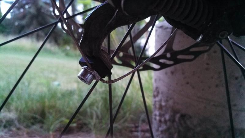

    I just did this tonight! Sram X9 9 speed shifter, Sram PC-991 Chain, Sram PG-980 11/34 cassette, Shimano Zee freeride rear der.
    I bought a longer pinch bolt and square nut. filed a groove in the nut for the cable. pretty excited that this worked. thanks to everyone who contributed to figuring this out. Oh and Big-Ted, those spacers are sweet!
