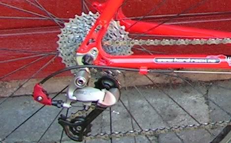

    me too. haven't noticed any extra friction in the RD cable due to any gunk in the cable. my setup:
    if your RD cable comes down from the seatstay(and not along the chainstay as mine do) i guess the bend of the cable would be about non-existent => even better.
