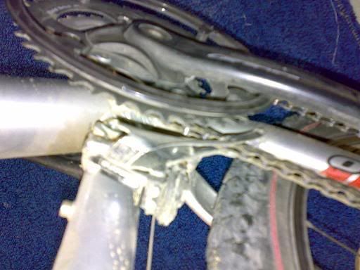

    Reputation: demonx's Avatar
    Oct 2007
    20
    Thanks to all who have posted.
    I tried to take a pic of the drive train but it didn't really turn out too great - the reason I was asking about upgrade is because its just the stock/out of the box parts and not an aftermarket set up - so it's sure to be crap and easily improved.

    Reputation: WorldWind's Avatar
    241
    Taking a pic for the purpose of showing how your drive train is set up must be done in a wholly different way than that.
    Put your bike on its wheels supported vertically. Shoot from the rear square to the ground with a long depth of field and the big ring exactly on edge. The shot must be in focus. The chain should be on the small ring and the big cog.
