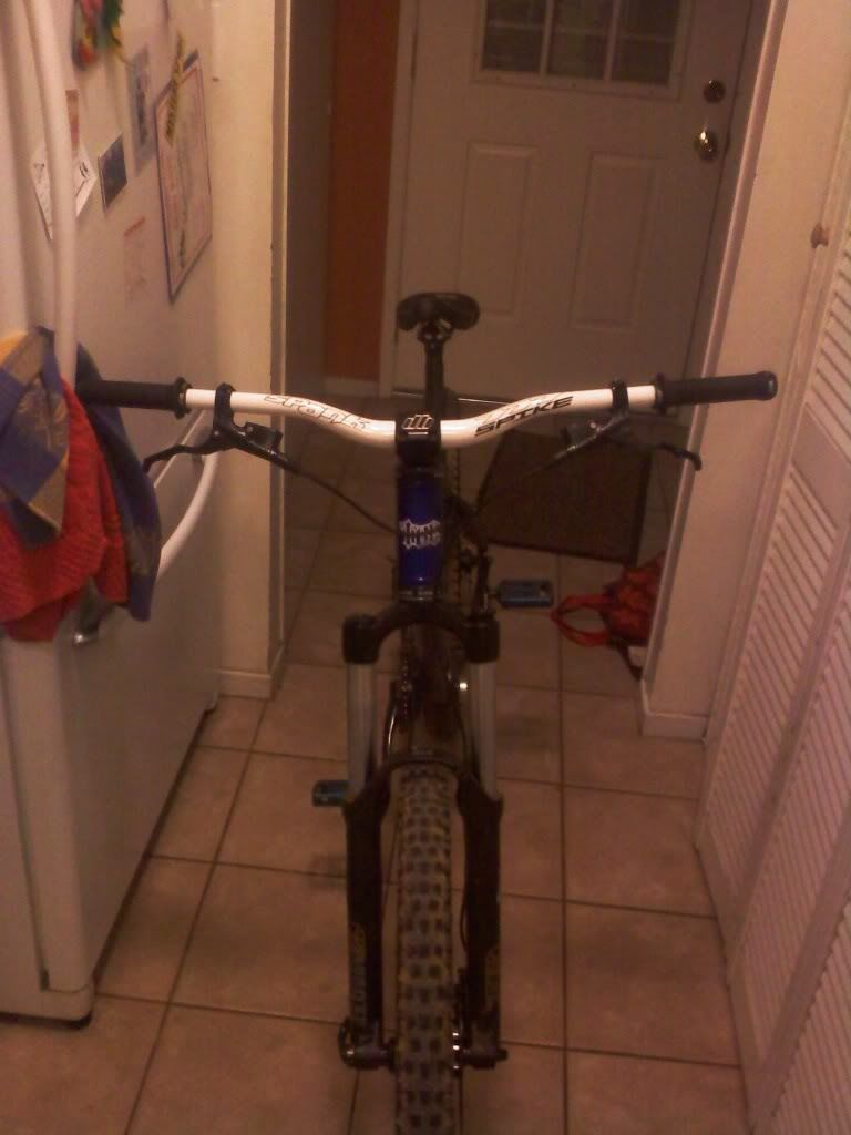

    Anything for you! for now, a celly shot will have to do, my mom took the camera to Hearst Castle.
    i can't really feel the flex while riding around, but i can deffinatly flex them just standing over the bike. i just rode about 15 miles total, and they were great!
    i kinda think i need to quit worrying and friggin ride
    Pics in a sec
    EDIT: verizon is being a b*tch....

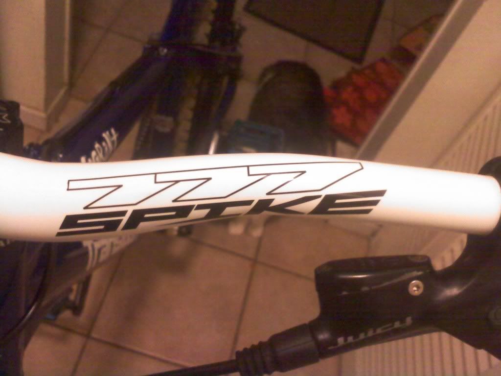

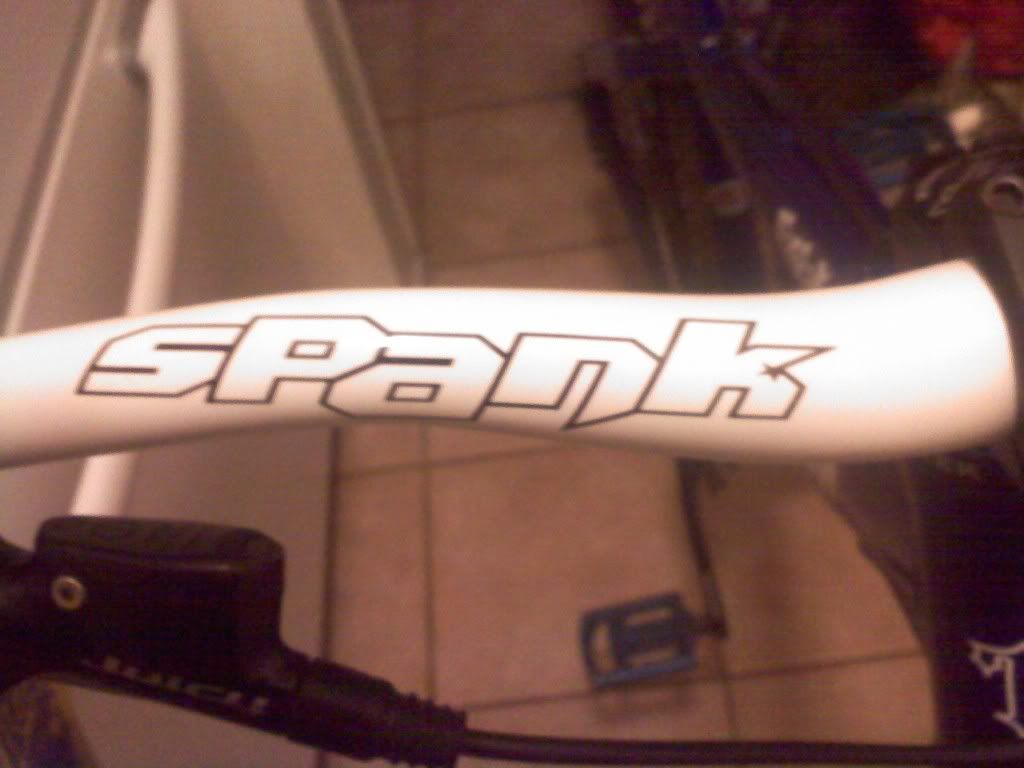

    damn cat knocked the bike over right after i took this one
    i need to turn down the brightness
    this finish on these things is amazing! the i'm pretty sure they powdercoat them? i was adjusting the brake lever position and i dropped my multitool on them, i got all mad that i had scratched them before i checked to see if they were scratched... not a single blemish

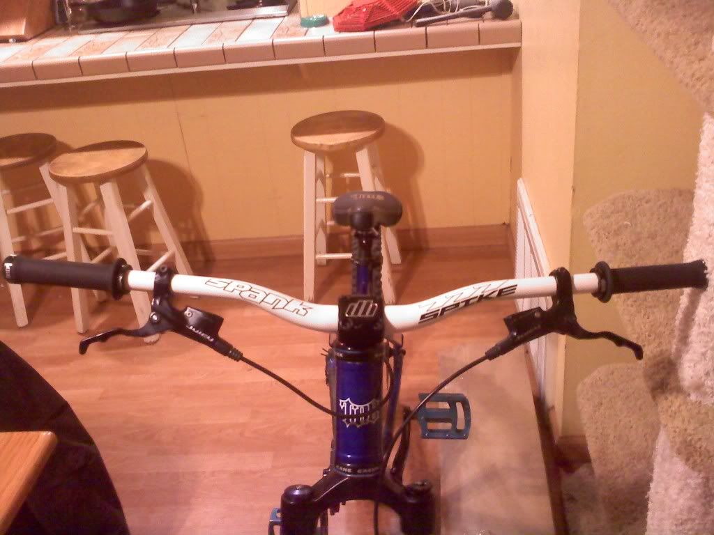

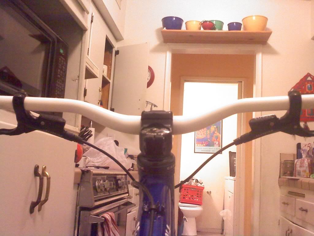

    Sure the stem is in complete contact w/ the steerer tube? I see no spacers, that is definitely not the stiffest setup.
    Also, the 777s don't flex as noticeably as the Sunlines in my experience. They feel pretty stiff to me. Part of it is that you're going from a 5" narrower bar so these will by nature have some extra flex.
    1,236
    theres one spacer in there, i've had a few people ask me if i had one in there
