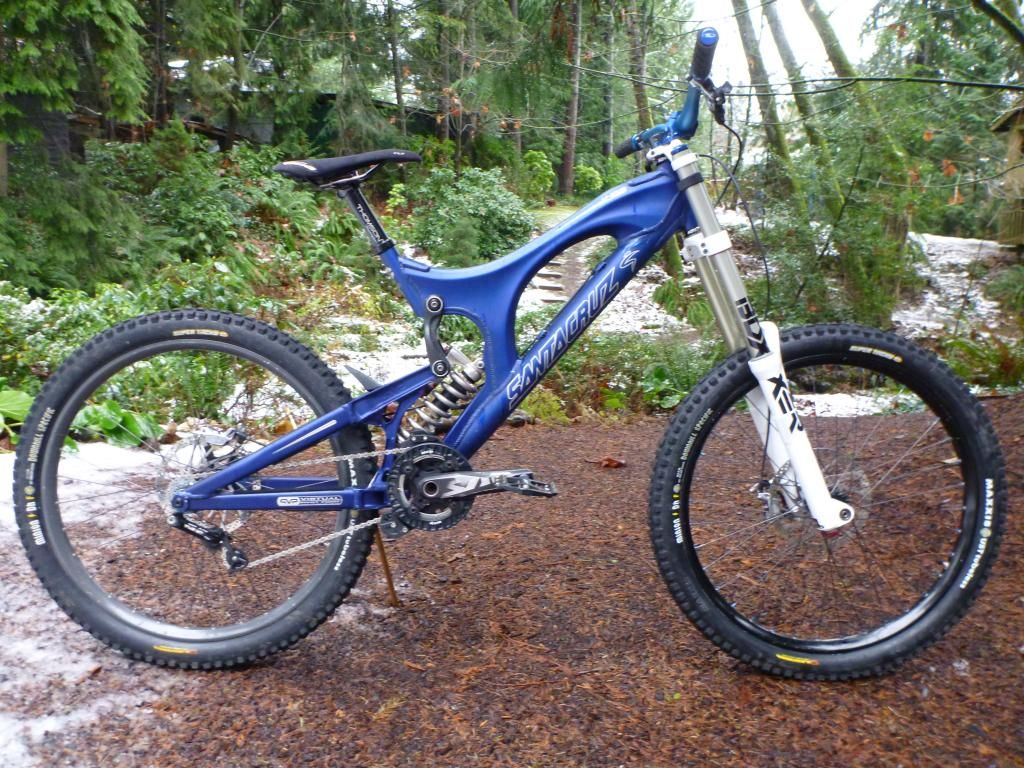

    My V-10 ss set up,35-18 for my local trails,and 36-16 for whistler bike park.
