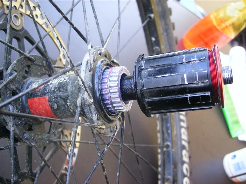

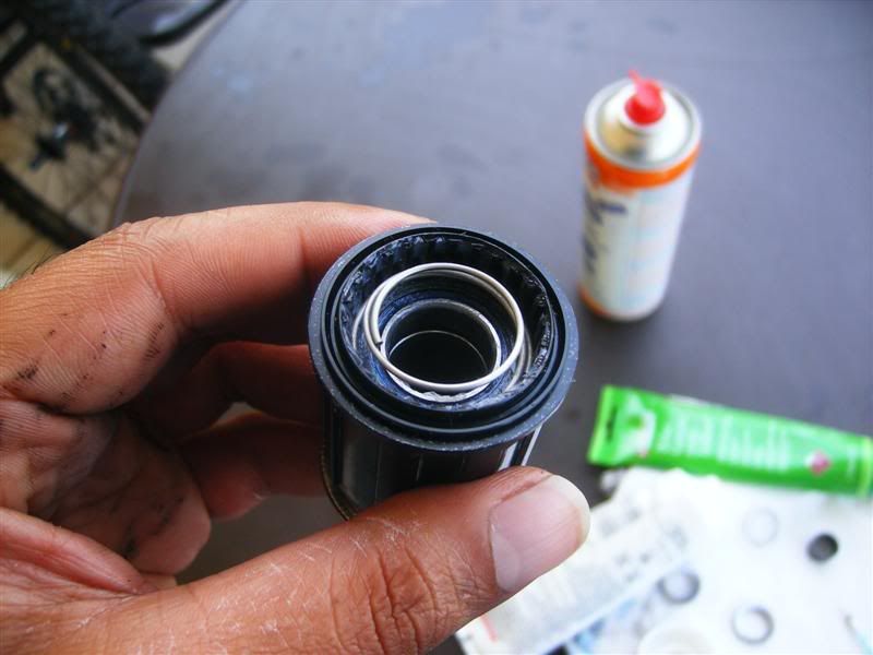

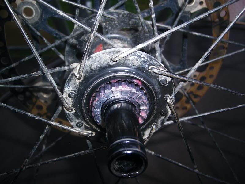

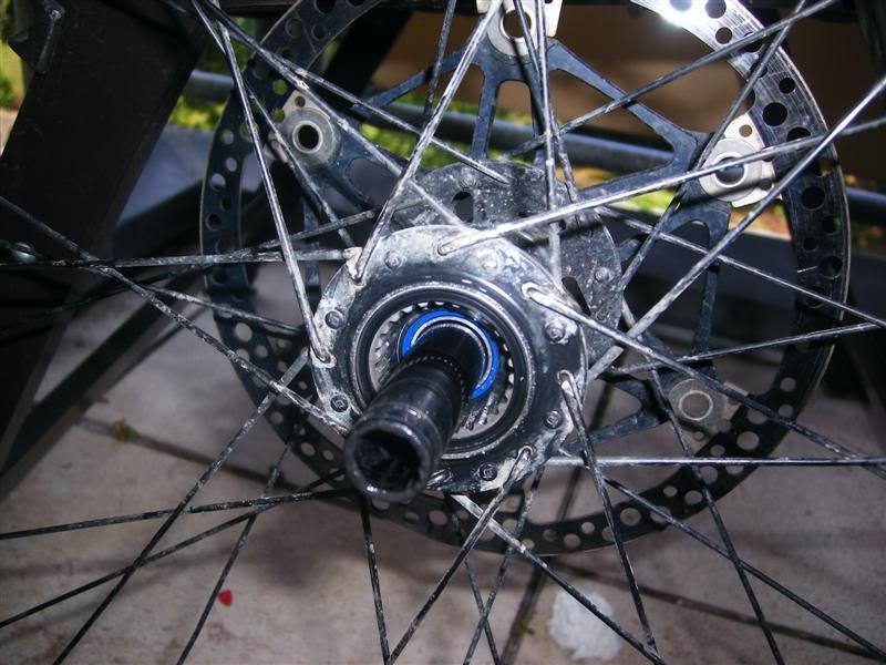

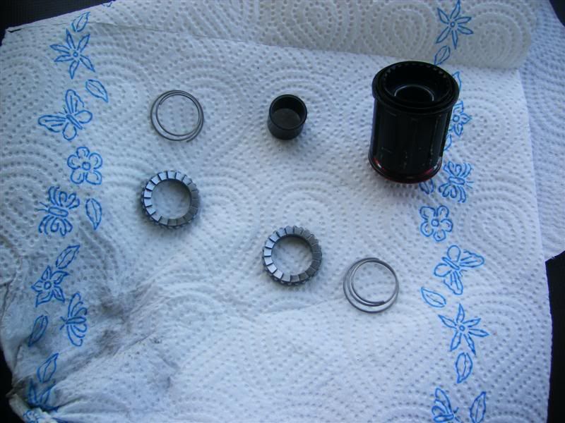

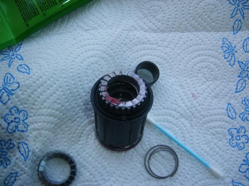

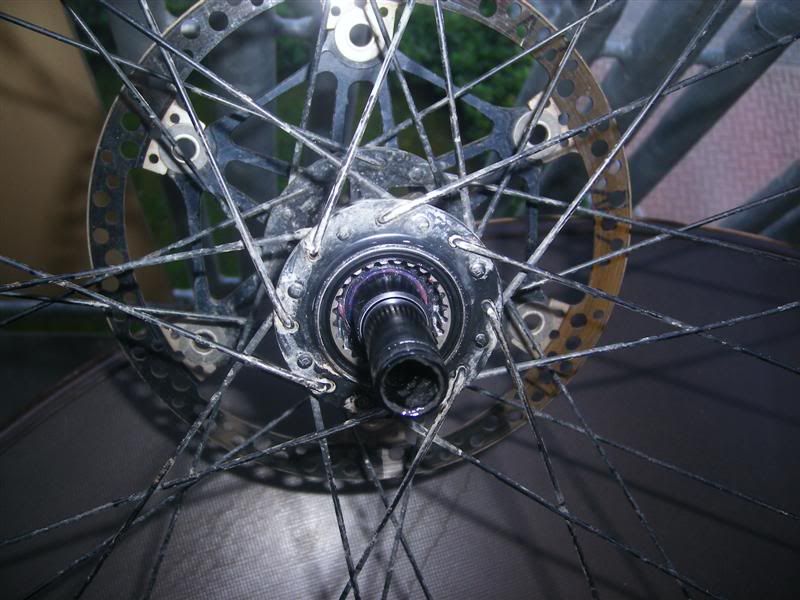

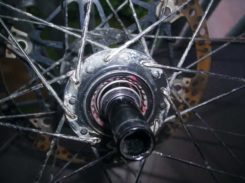

    Basically, here's what servicing the engagement mech would look like. I purposely didn't write any text because it's all self-explanatory. This is from my girlfriend's 240. I blended a light, slick automotive type grease with a small amount of a slick teflon-containing grease. No need to overdo it, either. Also make sure to get some grease in the labyrinth grooves for better sealing and water resistance. Conceptually, the Star Ratchet System is similar to King's concept. Execution is completely different.
    The hubs are three years old, have thousands of miles and a half dozen countries on them. They still look pretty new inside. That's what one can expect. The last time I cleaned and serviced them, it was 2006, after about six months just to see what was up. The innards were still clean this time around.
    Honestly, I9 is nice, there's that engagement point thing, but if I had to, it would be the DT, even at lower POE.

    107
    Grease
    Thanks OP.
    For those doing this mod - which I recommend. SUPER easy and a dramatic improvement in performance. Esp for technical stuff.
    This should explain why you want grease w certain properties in key places.
    Before that, you prob have a little nice DT grease already without knowing it.
    If you have not prev serviced the freehub, there will prob be enough fresh original DT grease completely clean, on the INSIDE surface of the original star ratchets.
    I mean around the circumference of the hole in the centre of each ratchet.
    Just run your clean pinky finger around the inside of each of the old ratchets, and put that clean original grease on the ratchet teeth of the new ones and wipe the rest on their inner circumference.
    Use your thinned syn grease for the other surfaces and to make up any deficiency in quantity.Thinning w synthetic motor oil like Mobil 1 seems to work well.
    Buy a jug bigger than you need next oil change and have the mech give you what's left in the jug.
    NOTE.
    You do not want sticky grease on the inner or outside surfaces either.
    The springs have to be able to slide these ratchets together quickly when you crank.
    They have to slide quickly enough to fully engage before the leading edges meet.
    Viscous grease will have them slide together more slowly (smoothly, but too slowly) under the relatively weak pressure of the original springs.
    If you use viscous grease, then when you crank, the spring will not slide the ratchets together fast enough for the teeth to fully engage each other before the leading edges meet.
    Crunch!
    Equally, this could be solved by using stronger springs. But that in turn will likely make them louder. And you would have to be pretty sharp to find the right springs versus just using the old ones and appropriate grease.
    I guess you could deliberately plastically deform your existing springs by stretching them to pos offer more pressure. But I would not recommend it unless you are pretty confident and controlled.
    Maybe DT should have supplied stronger springs w these ratchets anyway just to avoid any problems. And/or some grease.
    Using thick too much grease on the outer or inner circumference will lead to exactly the problem that some have reported - chipped ratchet teeth as you will be applying power with the teeth only partially engaged cos the ratchets slide together too slowly when you give a sudden pop w the cranks.
    So make sure they can slide freely. Better to use thick oil than v viscous grease. Just service regularly and only use fully syn so it doesn't mess w the rubber seals.
    Obviously leaving even a little grit inside, or some getting in through the seal w water. could also keep the ratchet teeth partially apart by getting between them. Or could cause the ratchets not to slide, also keeping them partially or completely apart...
    So make sure there is no grit.
    Don't get any in there when cleaning your seals. And the advice in the thread about greasing the seals to prevent any getting in later is also v good.
    For seals, the choice of grease is up to you.
    I use thick enough to stay in there, but as thin as it can be to achieve that.
    Finish Line Teflon Syn is good for many jobs when mixed w syn oil as/when nec.
    Hope this helps people avoid the problem w chipped teeth that has been reported in at least one other thread.
    Enjoy easy, cheap, excellent upgrade!

    Quote Originally Posted by Jerk_Chicken View Post
    I think they likely have to use better bearings, as it's apparent they aren't using the best ones they can. Tony Ellsworth uses bearings in his wheels that have more balls and they also happen to be bigger balls.
    As far as the spokes go, no one is bound to them. They work for some, but the criteria for others is not the same. For that, they have the classic. The only problem with the classics are is that they aren't light for the price.
    DT will be doing 36 points soon, and it will likely be retrofittable star ratchets. Hadley and King are alternatives as well.
    The nice thing about the DT system is that it's simple to work on (most in this class are anyhow), few moving parts, and when engaged, it's a solid locking of parts, nearly as if they were one.
