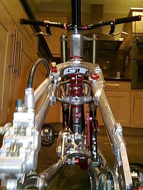

    why 203 rear and 160 front for your brakes?
    And which direction does the rear spring travel? no getting hung up on your seatposts right?
    Old frame, rear wont take a larger disc as it would simply eat into the rear stays. 203mm at the front cause I'd like it to stop!!
    The rear shock is termed a 'pull shock', it actually pulls the rear linkage up when compressed. Basically another flawed design by todays standards but when these arrived on the scene BITD they were like OMFG I want one. Cost around $4K out of the box though and thats without race upgrades. Problem was the linkages were very prone to breaking and the bonding could sometimes come unstuck causing problems around the headtube.
    I built this up as a 'retro' passion just for myself. No intention of pushing this beauty down any Black graded slopes. Thought I'd share with some of the younger members (Oh god I'm getting old!!) how these bikes used to look and just imagine the WOW factor these had in the LBS 12 years ago

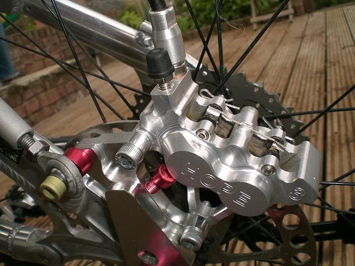

    Can you show us a pick of the rear brake mount and that arm bolted to the canti boss?

    There you go. Seriously considering getting some disc tabs mounted though. It's OK for now but I have in the past seen some frames that used these get the Canti Boss ripped out

    Just curious....there's a red aluminum bolt that is sticking out just under the caliper body....what's that for?? Can't wrap my head around that one....
    Oh, and don't forget to run the nut up on the eyebolt on the brake arm. And lock it and the upper one down nice and tight too.

    the number 3 ont he side of the hope caliper, what does that mean? i have the number 4 on the side of mine and always though it meant 4pot, but yours is a 4pot as well?
    The number on the caliper related to the size of rotor.

    Close. Back in the day if you changed bikes, forks or possibly rotor size. you needed a new caliper-half. The number is for the caliper-half, which obviously mounts to the bike/fork (and the other half of the caliper). I had the old DH4 brakes and they were great, but I was pretty much stuck because I was running them on a Boxxer and the Boxxer had it's own caliper-mount standard apart from everything else, so it had to have a specific caliper-half from Hope.
    ah yes that would explain it. i was wondering why my lbs ordered in a new calliper half when i had my boxxer fitted (amongst other things)

    Just curious....there's a red aluminum bolt that is sticking out just under the caliper body....what's that for?? Can't wrap my head around that one....:confused.......
    That small Red bolt actually provides a small amount of adjustability and gives some extra rigidity when setting this up. Tightens down on the rear stay and locks it in place. It's Red, it's Bling and suprisingly does actually work. I am however looking at getting Disc Tabs mounted, just need to find a reputable welder close to home.
    The numbering on Hope Calipers is specific to Rotor Size, Fork and/or Frame Mounts. Take a look on the Hope Homepage http://www.hopegb.com/
