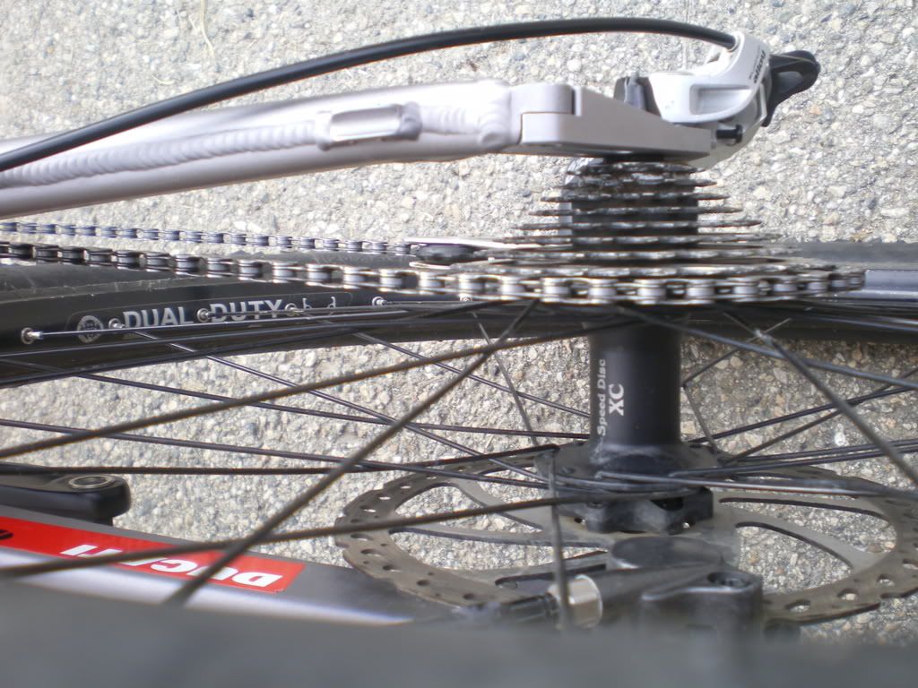

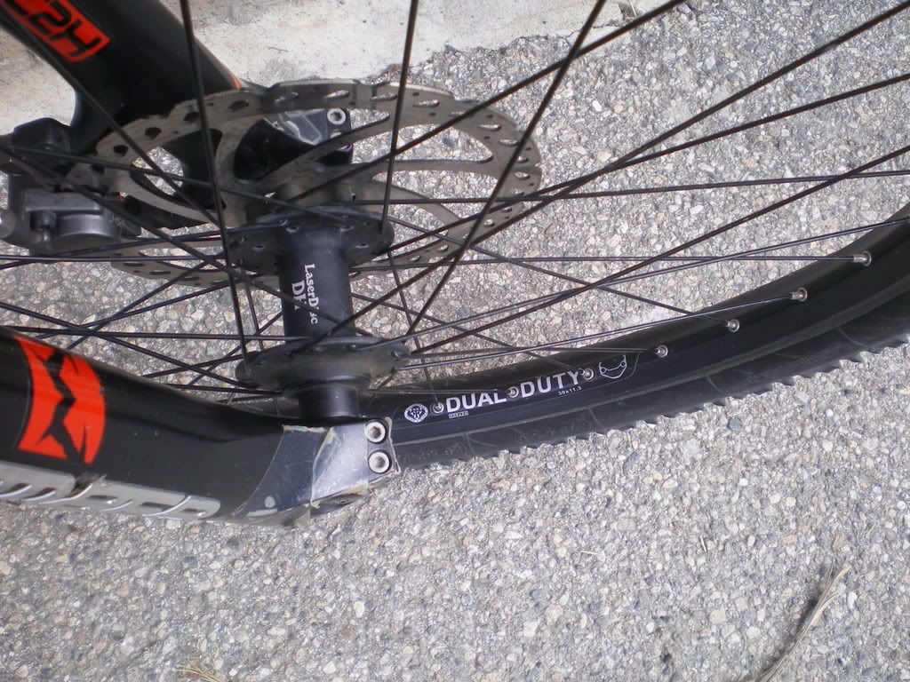

    Sorry about posting this all over the place but I wanna get opinions from different riding disciplines. This is because my lightest / most pedal friendly bike has 7x7 inches of travel and I do ride it sometimes at DH class trails that require alot of pedalling to get to or when my FR bike is offline. My WTB wheelset's rear spokes keep on loosening up much more than I can tolerate (5 rides) but as I mentioned earlier I don't want to slap my heavy Deetraks on it cuz I sometimes use it for Epic XC's and I don't want to go over it's current 35 lbs. weight.
    Pics of my wheelset / AM bike
