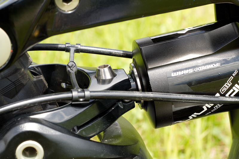

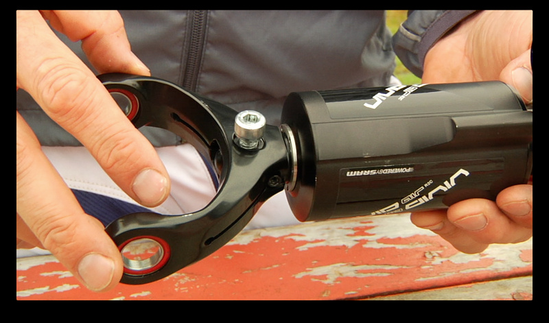

    On the rear shock, the issue you mention is it a space one or do you mean the shock mount that has the bearings? On the shock mount, I was under the impression that it is compatible with other shocks, it only requires that the eyelet and rebound knob are rotated 45º (like the S Works Enduro Carbon), given that the eyelets are all the same width.
    From the design perspective it does look like they missed some important stuff, but it does look like it's fixable (at least more fixable than say the Fox DRCV or Dyad on some bikes). On the other hand, we're moving more and more towards the "bike for 1 season" thing and the manufacturers (generally speaking) are thinking with that trend in mind too when designing.

    The shock mount thingy I was mentioning, by the way:
