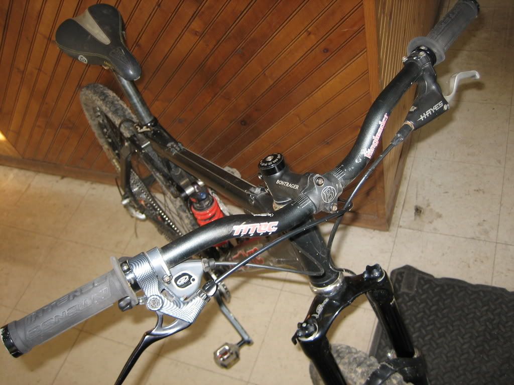

    I'm looking to possibly pick up this bike, but am not really familure with it. Id like to get into a freeride bike and this just happened to pop up. The guy is really knowledgable and let me take this for the weekend.
    After riding it, im ok with it. It definitly pedaled good, little bob.. im up in the air about it. What do you guys think?
    i'd probably pay 600 for it.

    Not a bad deal. I would be sure to check the frame really good for any stress fractures. The Saber is like SMT stated a good all-round bike - light FR bike. I almost bought a used Saber before I went with the transition dirtbag. Here is a link to a review form Dirtworld

    also watch for ovalization to the lower shock mount....mine is slight right now

    Thanks guys. I know the headseat is FSA and has play, so it'll have to be changed. The rear triangle and those shock mounts all seemed nice and tight.
    It seems like the kinda bike I'd like in the long-run. As well as this, I've been looking at a Felt Redemption frame/shock which poses the same attributes as the azonic...

    On the flip side I had a Saber and it only lasted a bit over a year. I had to replace the lower chainstay because of stress cracks. Then I crashed on it and at least the seatube was bent but, I couldn't say for sure if anything else was. Not exactly sure what happened to the bike in the crash but, I was pretty surpised because I was riding some agressive trails and not doing and drops or huge jumps.
    Also, Azonic told me this is NOT a freeride bike but, rather a trail bike. Be careful!

    Great all-rounder. Going on two years of riding a used frame that I picked up from a buddy. More AM/lite FR than FR as stated, but classic Horst Link design that pedals great. Anything over 140/150mm in the front raises the BB pretty high, but I run it w/ a 160mm fork and love it.

    Theres an issue with these bikes if you plan on running it in 6 inch mode. The rear rocker will hit the frame on bottom out.
    I had an 04 Saber and it clunked all the time off drops.
    In 5 inch mode (as shown in pic) the rocker does not move as far, thus no bottom out.
    These bikes have also been notorious for blowing out the main rocker bolt, as it is aluminum, not steel.
    The Romic shock might not be serviceable if it goes out or has already gone out. You can tell if it's blown by not having any effect when you adjust the rebound and it makes a lot of slurping noises. It's usually still ridable if blown and not leaking oil, although performance might not be great. I rode a blown romic on my Saber (came blown out of the box) for 2 years.
    Considering what you might have to pay to replace or fix any broken parts, I would say $4-500 is more reasonable for a nearly 5 year old bike. That's also because the bike does not appear to have any upgraded parts from when it was built (likely in 03 or 04).
    On a good note, that frame has the updated chainstay, which should hold up great! Older chain stays were known to break.

    what determines if its in 5" or 6" 'mode'? I've looked at it, and it doesnt have any signs of bottoming out that I can see. I'm still fairly new to these setups. The rear shock seems like its been rebuilt before, b/c i know that he changed the spring out and had some kinda work done on it. It definitly feels good and not squishy at all.

    Looky here. See how the shock can go into two sets of holes?
    The outter one is 5 inch mode, the inner one 6 inch.
    If you plan on running 5 inches, then don't worry. 6 inches, you're guaranteed to hit bottom. Using a progressive shock like a DHX with full bottom out reduces the number of hits greatly.
    All said, my 04 Saber had a DHX 5 on ther eventually and it rode really well!
