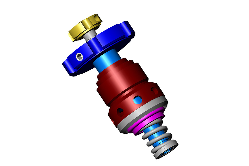

    1st: Fox DHX race tune - removes the propedal and its replaced with a HI/LO speed adjuster and its revalved as well as modified to make it speed sensative. His price with consumables and seasl is $199
    Heres the hi/lo it will be out Aug 12th

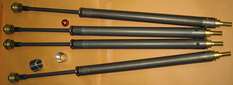

    4th: Fork cartridge it fits 888s, boxxer, kowa and they are doing one for the fox 40.. The main one for the majority is interchangeable with adapters and has hydraulic bottom out so bumpers etc are old school no more packing up...
    Now I have had time on hte hi speed mod as well as running a preproduction adapter kit with the cartridge in my 2010 Boxxer WC and they make a huge difference. The Cartridge is in a league of its own.
    Review for the Fork cartridge:
    OK so the first thing It took it apart and looked at the machine work and went over it plus the reassembley to see how easy it really is to install and its SUPER easy.... Oil height is 245ccs 85/??? golden spectro synthetic (light anti foam and approx 3wt).
    athe compression is on the bottom of the leg and the rebound is on the top and WORK GREAT....... The whole assembley is so well designed and easy to install its nice, the whole feel of the cartridge is amazing from start to finish....
