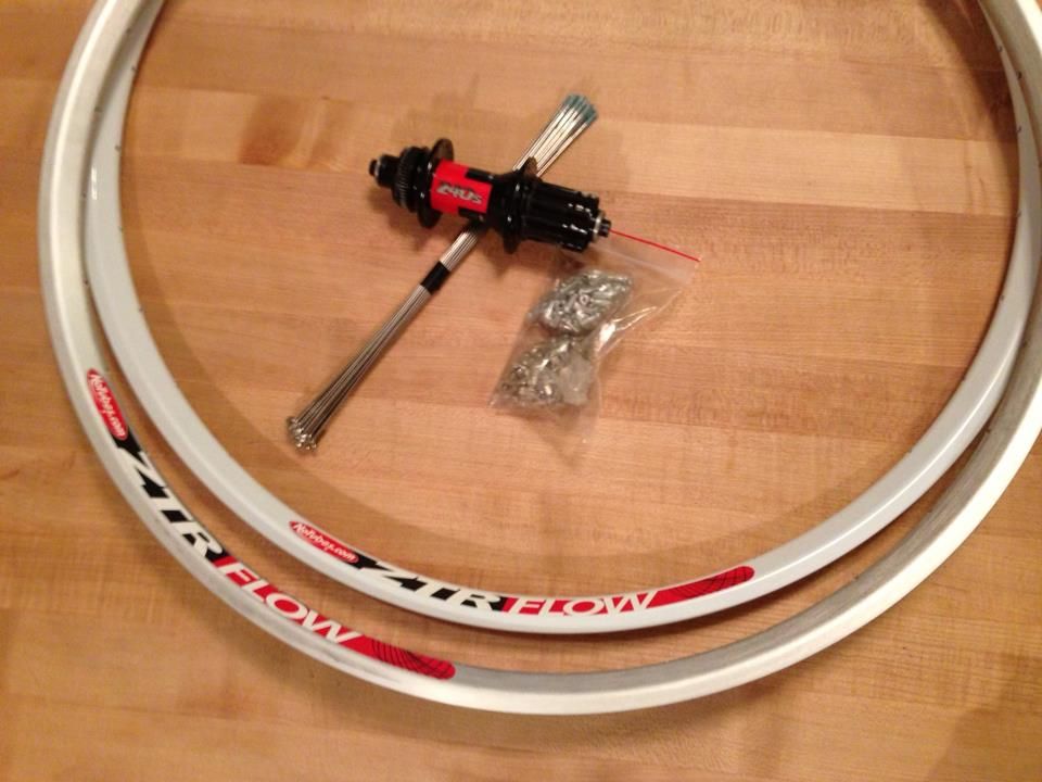

    Got a pair of Stan's Flow rims in white on clearance...but I hate white and its an added 20 grams.
    I've used aircraft stripper before but it's effectiveness really depends on the paint/ powder coat being removed. Anyone have experience with Stan's white powder coat?

    citristrip from walmart. Apply thick, put each wheel in a garbage bag and push the plastic onto the surface. hang in warm area for 4-6 hours and come back with steel wool. shouldn't take much muscle at all.
    I just stripped a frame and it took about 5 minutes of steel wooling to get completely bare.

    Here it is, turned out great!
    I highly recommend CitriStrip. I was very skeptical but it works!

    186
    Yeah, it is hard to tell in the pictures. In the top picture only the rim on top is stripped. I took the stickers off and then reapplied them.
