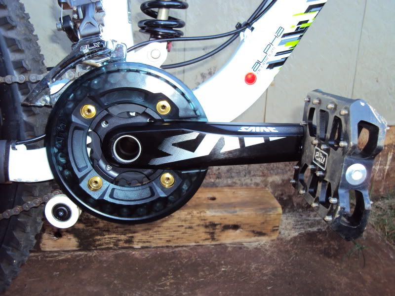

    *Update* I've been having problems with the Raceface Ride cranks coming loose every ride even with Blue Loctite. It's pretty irritating so I have a set of Saint M810s on order.

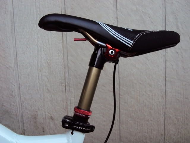

    A must have. Crank Brothers Joplin R. Just don't pick up the bike by the seat unless you raise it all the way up. If you don't raise it all the way up and pick the bike up, air can get in and it'll raise up on its own. To purge the air you'll need to loosen the top cap, push the seat back down, and retighten the cap.
    Reputation: Karve's Avatar
    Mar 2006
    1,442
    Quote Originally Posted by rat7761
    Have you tried taking them off the bike and tightening the crank all the way down to the end stop then refitting them?
    Reputation: rat7761's Avatar
    337
    Quote Originally Posted by Karve
    I didn't take the cranks off, but I do feel them positively bottoming out when I tighten them down. I heard a lot of people have similar problems with this type of Raceface cranks coming loose. I like the way the Saints are designed a lot better anyway. I've never had any issues with Saint cranks.

    Got the new Saints mounted. Problem solved.
    Had to use about a 4mm spacer on the drive side bottom bracket bearing shell. With one 2.5mm spacer, the small ring would rub the chain guide mount. With two 2.5mm spacers, the crank assembly would be too far outboard.
    Note: The bottom bracket on the Scratch is 73mm.
