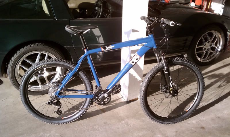

    Put a rigid 29er fork and 29er front wheel on for a 96er Response. Head angle change was minimal and I really like the way it rides!
    Attached Thumbnails Attached Thumbnails Upgraded DB Response! Post your pics!-my-96er.jpg

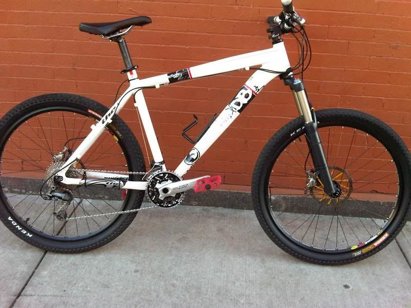

    Upgraded 2014 Response XE
    It's nothing special to most but I've done almost all the work myself except for building the wheels, I had those done at a lbs.
    Mavic rims/XT Hubs
    Sunpeed handlebars and stem
    RaceFace Sniper grips
    Cane Creek 40 headset
    Rockshox 30 Gold fork
    Saint Pedals
    11-32 8 speed cassette
    I imagine it's under 30 pounds now, haven't weighed it.
    Attached Thumbnails Attached Thumbnails Upgraded DB Response! Post your pics!-20150915_125009.jpg
