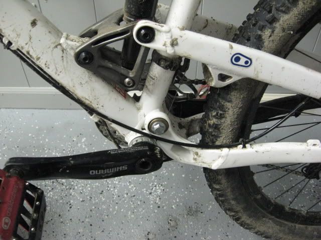

    Quick trip to the hardware store. This will have to do until Performance bike gets a hold of DB. Its ugly but strong.

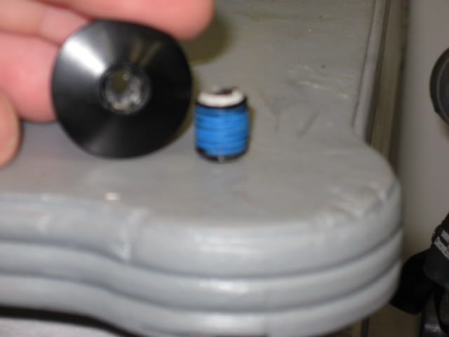

    At first look it wasn't going to have anything I could use. Took the bolts out of the knuckle box and started to measure. Success. The two lower pivots are the same dimensions.
    After install. I know I need to clean my trusty ride.
    I rode 4-5 times with my hardware fix. Never felt flex in the rear. But this is the way the pivot should look. Thanks again for the heads up on the ebay kit. BC Multisport thanks for the fast ship and great deal.
