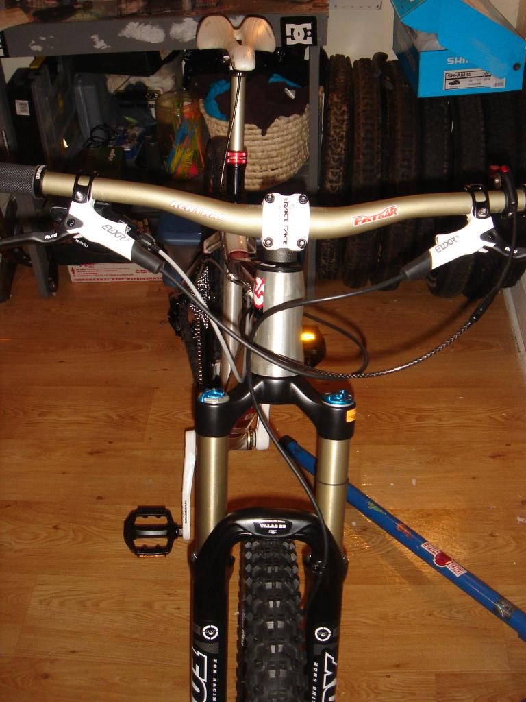

    Built Mine up. I swapped out a few parts right off the bat, I'm still waiting on a crankset, brakes and tires to swap out. Here are a couple pictures, I'll post my initial thoughts and observations when I get a little more time.
