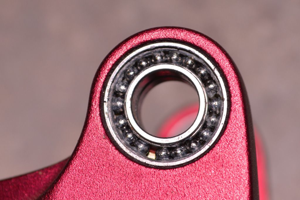

    So I took the seals off of 3 bearings. They are all very clean with plenty of grease. They look brand new, no scoring or pitting. This is after 300 miles of riding in dusty Arizona, the dust here is very fine and can sneak into small crevices. I wasn't expecting any scoring at all, but I was expecting some dirt. So now I'm completely stumped. There is no reason for these bearings to be seized. I can't figure it out. Here are some pics.
    This is one of the small bearings on the knucklebox, it is seized and refuses to move. Not dirty at all and has plenty of grease. I thought that maybe it had too many bearings. It has 18, which is the same amount as the other bearing which is exactly the same but moves freely and smooth. Maybe when it is pressed into the knucklebox, the tolerance is too tight and it can no longer move?

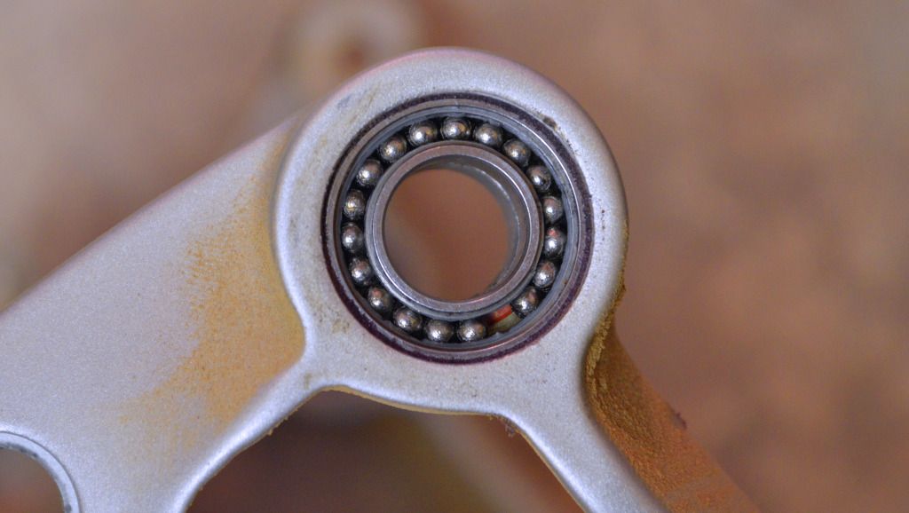

    This is the big bearing on the knucklebox, it is clean, and moves just fine. Thought I would take the seal off to inspect it.

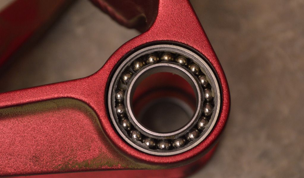

    This is one of the small bearings in the rear of the swing arm. It is exaclty the same as the small ones in the knucklebox. However, these 2 on the right side, function just fine.
