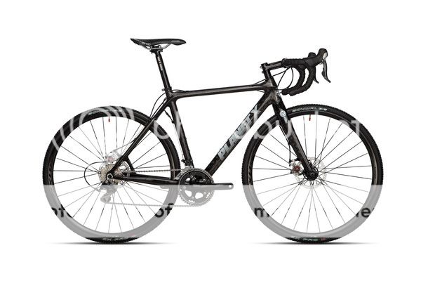

    Hmm, I am wondering where I can find the rake number for the XLS fork, as I am not averse to changing it if it solves the issue - the figure doesn't seem to be listed though :s
    Planet X XLS Shimano 105 Cyclocross Bike | Planet X

    Quote Originally Posted by Marc2211 View Post
    Try calling the U.S. store. Might get better results.
    You really don't need the specs to see that there is minimal clearance.

    And I would add that the fork looks pretty normal. Ie, it is frame geometry causing the toe overlap which is what I would expect.

    I'm not familiar with the Planet X geometry, but I'd bet it's probably set up with a 45mm offset fork, and likely a 72.5 degree HT. You can get similar handling characteristics by combining a slightly slacker HT w/ a fork with a tad more offset to counter the slow steering that slack angles create. For example, the Spec Crux (in 56cm) has a 72 deg HT combined with a 49mm offset fork. This accomplishes two things: quick (almost too quick) handling with longer front-center to counter toe-overlap issues.
    edit: just checked the Planet X website. Turns out that frame has a crazy-slack HT. If you're having problems with toe-overlap on that bike, you have a couple of options. 1) cut off your toes and get new shoes, or 2) weight your outside foot while turning instead of pedaling through turns.

    This is the minimum overlap I can get. This is with the cleat all the way to the front of my shoe - I am really not sure I could ride like this for more than a few mins.
    The 165mm crankarms are really not going to help.

    Thanks for the reply and taking the time to post in detail - it genuinely was enlightening and appreciated. The Strawberry Cycleworks link really did shed light on things and highlight even more the issue I have faced. Despite not being a 'young 'un' at 36, I think I've probably been spoiled by my MTBs up to now, so have not had to 'ride around' this issue before - that being said, I found it hugely difficult on low speed uphill tight bends, when normally I'd *have* to pedal and don't have enough momentum. I am not sure I could ever get around this.
    As you say, I've accepted that my 'new' bike is for the chop, there is no point crying over spilt milk - lesson learnt as this was the first and last time I buy online without actually trying a bike. I've already been trying out a few other bike options for when the wrist heals - I took into account the measurements and newly identified geometry requirements, and have been amazed by the variation between CX bikes produced.
    Kona and Felt didn't work out (same overlap issue), the Specialized Crux worked well for me, as did the Trek Crockett - but both were on back order for 4+ months (and for the Specialized, eye wateringly expensive for what you get). However after heading to my local LBS (a one man semi-boutique/Trek store, with whom I have a good rapport), he suggested trying a used bike that he had just got in, a 2012 Trek/Gary Fisher Cronus CX Pro.
    It was a size larger than I expecting to take at 56, but gave 2+cm clearance when clipped in. As you say, I've had to reduce the stem from 100mm to 80mm - but the fit is perfect.
    Many lessons learned.
    Thanks once again,
    Marc

    Im 5'8.5"s and ride a 55cm frame with a 56.5 ETT. no overlap with 35c USH tires. If your on a 54cm "compact" frame chances are it was to small.

    I am absolutely pleased to hear of this outcome, I hope you have many pleasant rides now.
    It is difficult to put simple frame principles out to the 'layman', but due to the struggles and obvious responses to those following this post, well worth the effort, if it avoids others also tripping over this issue as well.
    As an overall perspective of frame design, in your case, the CX bike you bought, being short of length in the top tube, the bikes handling would give you very nimble, quick steering, because the short front centre allows for a tight turning circle that you need in CX races. Going out longer in the front centre slows this ability down a bit as you now have a wider turning circle, though in reality, it's not that big a deal. Better to remain up-right and going a little wide on the turns than fall off. Also, coming from a MTB background using bikes that have a lot of front centre, your new ride will feel quick anyway, so adjust to it and enjoy yourself.
