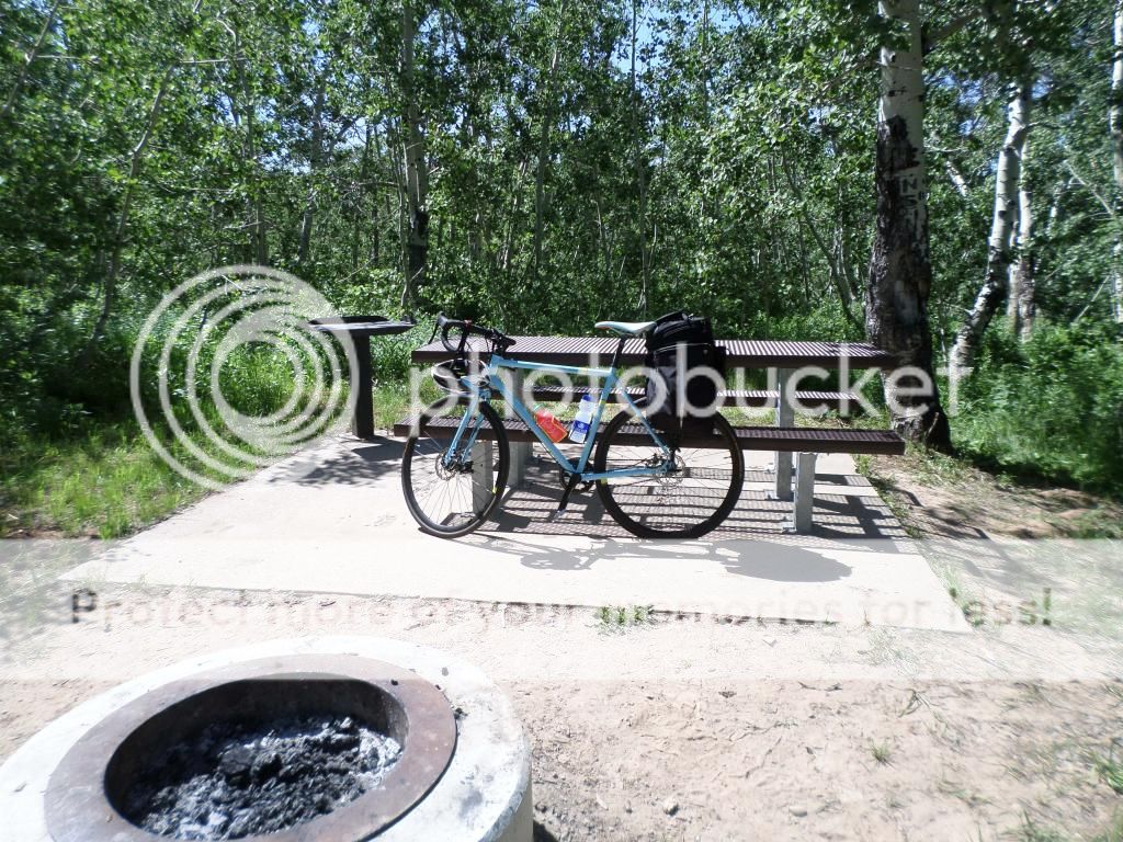

    Thought I'd add some more of my experience with this bike...
    Two weeks ago, I loaded up and went for a Sunday cruise that ended up being 74 miles when I pulled back into my drive way. This bike, while being a bit more aggressive than my Defy, is extremely comfortable to ride. I stopped every 20 miles or so to stretch out and go to the bathroom if needed, but it's a pleasure to sit down and spin. It also feels pretty good to take a 35+lb. loaded bike out and pass 8 different cyclists on their high priced/lightweight bikes while going uphill.
    On the ride out I was heading straight into a headwind that was mostly just annoying, but did slow my speed down substanstially, averaging only about 14 mph. Coming home, with the wind at my back I was averaging 19 mph with the stock gearing. Still suprises the hell out of me, as I was convinced I wanted to go smaller in the back. I have no need to, and will actually be going bigger when it's time for a new chain so I can spin up even more hills.
    I did switch out the stock brake pads for some Kool-stop pads, and it made a huge difference. I plan to keep running the stock brakes for the rest of the season. Next winter I'll put some Avids on and mess with the gearing a bit. I'm hoping the tires will make it through the season too. I love Schwalbe tires, but these CX pro things are wearing a bit on the quick side, and not the thickest. I'd prefer Marathons.
    My frame's got a lot more scratches now, but I think I'm finally past the "it's new, don't f#*@ it up" stage :). Now I'm hopping potholes, slamming up hills, and having a blast.
    I love this bike.

    Shinkers
    I did load this bike down on Saturday, and took it on a nice little road climb. 4000 ft. over 30 miles. I did have to stop 3 times on the way up to let the knees cool down a bit, but I averaged around 8 mph on the way up.
    I had some extra gear packed for this ride that I really didn't need, but I was testing out my new bag (with panniers) and wanted to see how I handled the weight. Now I know I'm ready for an overnighter.
    Next up will be this same climb incorporated into said overnighter for a 120 mile, 6000 ft. weekend.
    Coming down I hit 42 mph. Not bad for a SS geared as low as it is I think. I could have gone faster too, but reeled it in when I felt my back tire roll on a pebble in a corner :nono: (they just chip-sealed it). My goal the next time I'm up there is 50+.
