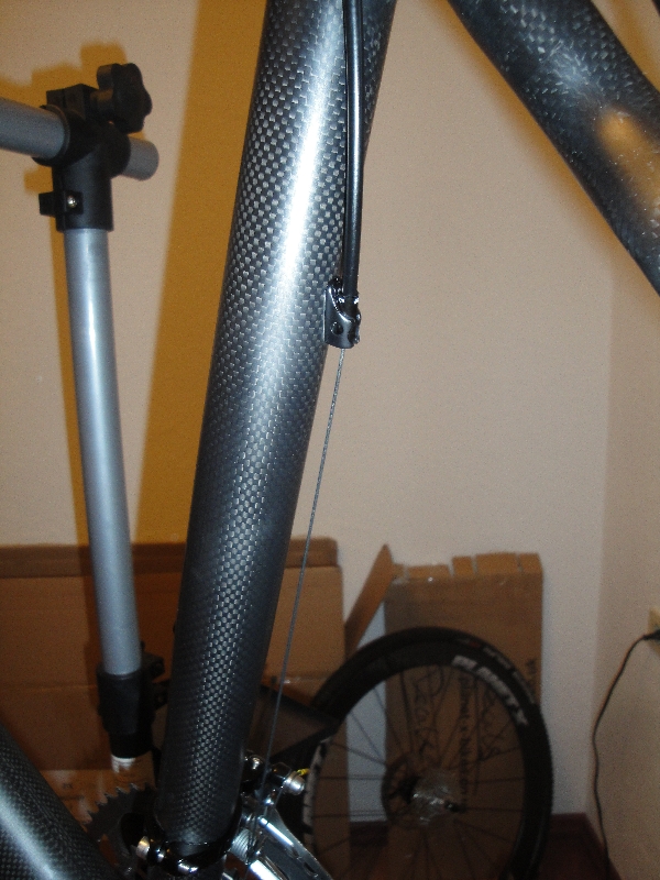

    I have a problem with a new dirty disco frame... After installing the front derailleur and swichting the chainring for the first time I noticed a problem with the cablehousing stop on the seat tube. If you have a look on the inside of the seat tube it seems like you can only see the lower "rivet". Is that as it is supposed to be?.
    Is there a way to place a new cable stop or should I just fix it with a cable tie or does the frame has to be replaced?

    This sucks, it appears the upper rivet is broken or missing and the other will eventually break, leaving you without a cable stop for the front derailleur.
    I do not recommend a band-aid fix like a zip tie, nor do I think the frame needs to be replaced. I think it could be repaired, but the first thing to do is contact On-One and see what they have to say.

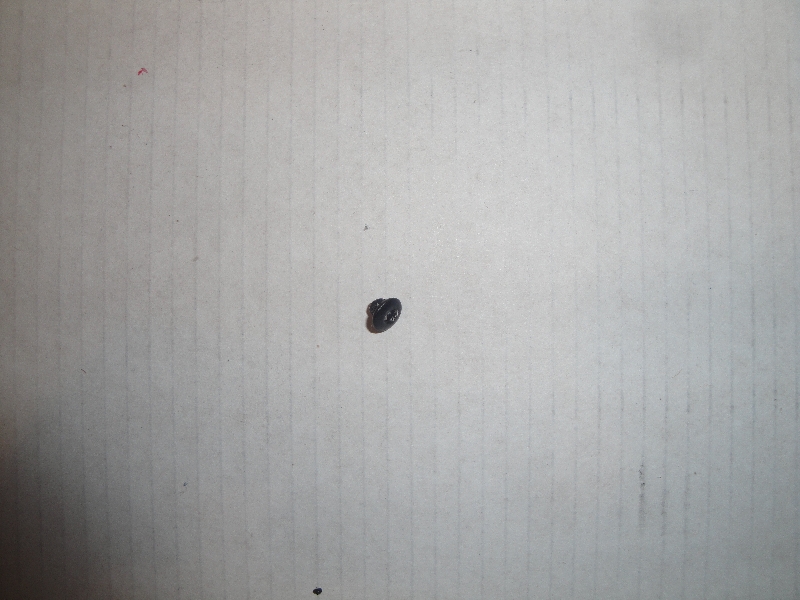

    I checked the rivet and it was broken in the middle. So there was no need to drill it out because you could get it easily out with a tweezer. I bought a rivet tang for 14 and did it by myself -> see the pictures below

    Good job. Keep that tool handy. Cable stops are riveted on all but the highest-priced carbon frames. I've got a DD and i'm happy with the quality.
