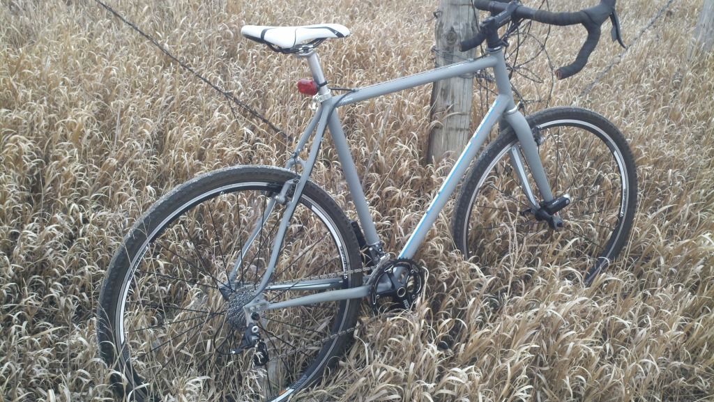

    My Origin-8 CX700 frame has that sort of setup:
    - DSCF1331
    - Product Description | Origin-8
    I removed the rim brake mounts, but it has threaded BB, rear facing horizontal dropout with adjusters on the front side, hanger for a RD. A bit on the heavy side.
    They also have a carbon version (CX700 Pro) but it is disc only, press fit BB and vertical rear dropout.
