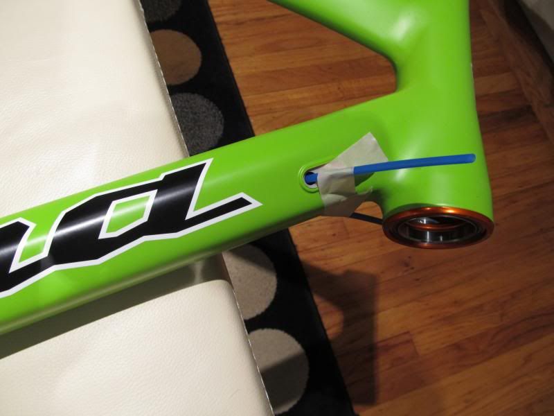

    Cable guides fished through.

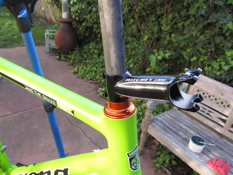

    Assembling Fork/Headset for sizing..
    Ready for cut.

    That's very interesting. Can you tell me more about the cable guide you used and the plates on the exit point there?
    I've got a 2013 Jake and a 2013 Jake the Snake, both of which use internal routing for the shift cables, but the cable exit is molded into the frame.
    I had a shifting problem recently on my Jake, and a local shop diagnosed it as an issue with the cable having worn a groove into the frame where it exits. They fixed it by running a plastic cable liner from the exit point to the bottom bracket cable guide.
    Did your cable guides come with the frame? I'm assuming you remove them after the cable is run? The cables on my Jake just feed into the frame and I guess there's something internal that helps them find their way out the other end.

    Andy_k, the plates where the cables enter and exit the frame are stock from Kona. Because this frame has been designed to also accommodate Di2, you get 2 sets of "plates". One set for regular cables, and one set for Di2, that are drilled to accept the rubber grommets used in Di2 setups. The frame itself has no cable guides inside.
