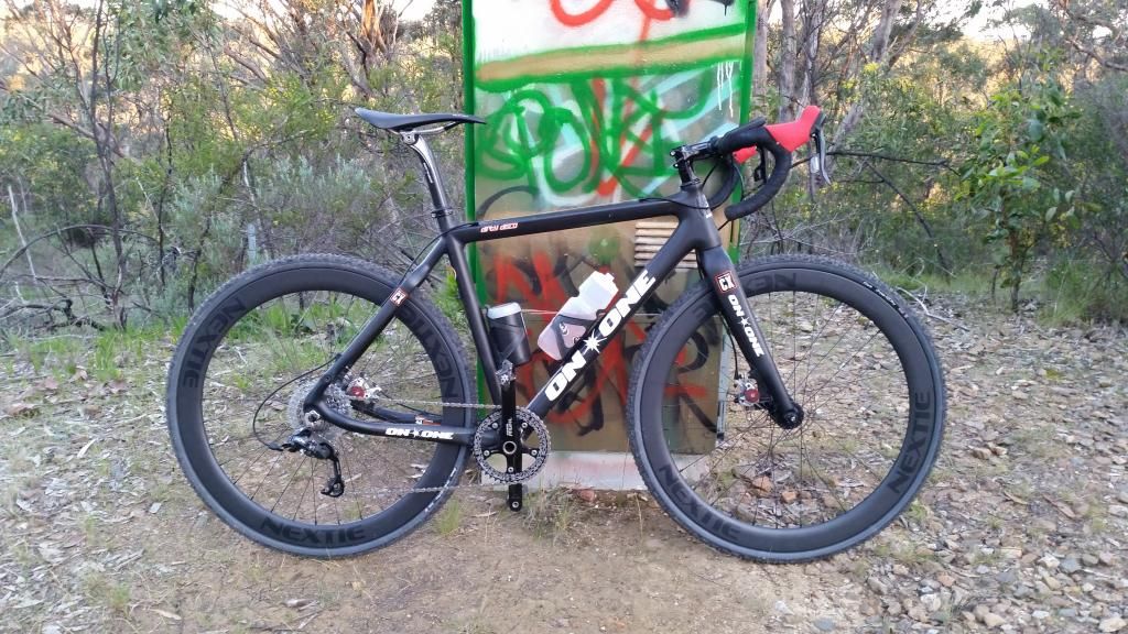

    My newest version of tubeless, got some Nextie 50mm tubeless aero's with Vittoria pro TNT's fitted at 40psi.... feelin sweet.

    Quote Originally Posted by ozzybmx View Post
    Digging that set up Ozzy. Any issues getting them set up tubless?

    Quote Originally Posted by chuckie33 View Post
    None at all, track pump set up first time. Got quite a few K's on them now with no issues.

    I setup the Crest 29 wheels with Hope Pro 2 EVO Hubs from my MTB on my Cross Bike with a set of Michelin Mud 2 tires last night to try in our first cross race of the season this Sunday. With the Hope hubs it was a very easy to switch the hubs from 15mm and 142x12 to QR 9mm.
