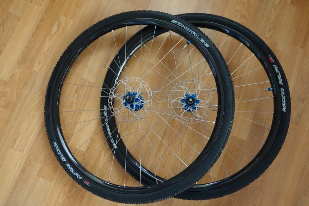

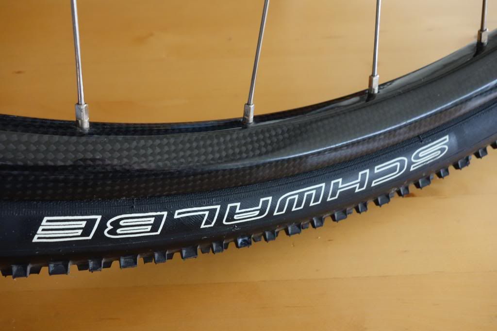

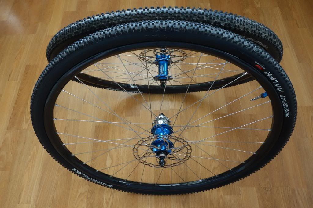

    Took these off to fit new rotors and thought I would post them up here as ive been following this thread.
    Lightbicycle XC carbon rims (21mm internal dia), hope hubs and DT revo spokes. 1560g wheelset. Set up tubeless with 3M 8898 strapping tape, stans and enve tubeless valves... I will be changing these out for regular tubeless valves when I need to refresh the stans as they were too long, hence the blue alu spacer.
    Evil Following
    Trek 9.9 Superfly SL
    IndyFab Deluxe 29
    FM190 Fatty
    Pivot Vault CX
    Cervelo R3 Disc

    Quote Originally Posted by ozzybmx View Post
    You are running the Schwable RR in tubeless, and which size? I am wondering as I have worn out my Stan's Raven 700X35 and looking for something with a bit more grip.

    Quote Originally Posted by (807) Recordings View Post
    Sorry, only seen your post. They are 33's, currently running Clement Las as tubeless.... nothing wrong with the ralphs, just wanted to try something with a flatter center profile.
    The Raven's might be a bit flatter, but also a bit less grip (rolls faster). Mine are 35mmX700. I may have to check the RR to run on my Bad Boy as there is not much space left, and I don't feel like going down to a 26er wheel.
    FWIW I have not burped my setup at all and I am always doing MTB on it. Usually in the 40psi range, but even less down to about 26psi. Lower psi though and tire roll comes in, and lots of rim bashing.
