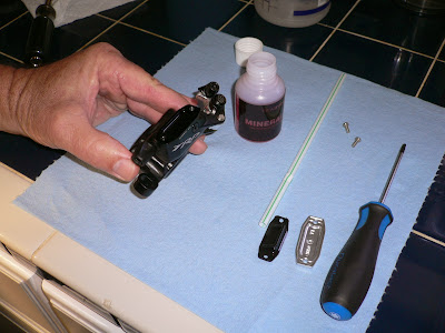

    Been riding mine for a month and a half with 105 levers, now the lever throw to get decent braking power on the rear caliper has grown so much that the lever is touching the handlebar. The lock knob can be locked and cables are new with compressionless housing.
    I'm going to try out the "topping off" method to add more mineral oil to the reservoir. Tektro send me a link to this youtube-clip:
    HY/RD Pro Tips With James Sullivan - YouTube
    Has anyone else tried this?

    Have you tried just tightening the cable? Barrel adjusters work (to a point) or you could just reattach the cable with less slack in it. Certainly much easier than messing with the reservoir.
    Reputation: tietze's Avatar
    May 2013
    11
    Quote Originally Posted by psychocross View Post
    The topping off idea sounds interesting but as soon as the pad wear equals the amount of extra fluid added you are back to where you started.
    No the calipers provide "automatic pad wear adjustment" even when topped off.
    Looks to me the extra travel issue should be sorted out on the cable side which is clearly a different issue with every bike.
    Quote Originally Posted by mudge View Post
    This will close off the hydraulic system. Opposed to topping off it disables the "automatic pad wear adjustment" and you will have to continually adjust the cable length.
    Nb. topping off worked for me :-)

    I have calipers from the first two US deliveries in 2014. Production changes include increased reservoir volume, revised gasket/diaphragm, a set screw on the plunger shaft to discourage manipulation, limiter on the barrel adjuster, and metal sleeves surrounding the pad pistons. The caliper from delivery #2 had long lever pull and vague engagement compared to #1. The top-off & purge procedure https://www.youtube.com/watch?v=S0i4aQ8S34w performed on #2 allowed a bubble to escape from the piston cylinder, which shortened lever travel and firmed-up feel a little.
    Note the use of a drinking straw like a pipette instead of syringe.
    I caution against adjusting the cable with barrel adjuster to the point the lock-out bolt is difficult to screw in; there should be minor drag, not resistance. If new cable & housing is installed with the caliper, re-adjust cable tautness after bed-in by screwing the barrel adjuster in, loosen pinch bolt, pull cable, tighten pinch bolt, and adjust using barrel adjuster. The latest barrel adjuster will only make 1.5 turns before spinning in place and that's not enough to accommodate housing bed-in on its own.
    SwissStop green (organic) pads perform well in my application.

    So the new calipers still require top-off? That's disappointing. I had hoped the new gaskets fixed that problem.
    I did my top-off with the calipers still mounted to the bike. It was a little tricky to get the bike positioned in the stand such that the reservoir was parallel to the floor, but I think it was still easier than removing and re-installing the calipers.

    Quote Originally Posted by HillDancer View Post
    ...The top-off & purge procedure...allowed a bubble to escape from the piston cylinder...
    The reservoir had plenty of fluid, the piston/plunger cylinder had a trapped bubble. I'm guessing my habit of tightening the cable enough to make the lock-out difficult to screw in & out was preventing the plunger from withdrawing past the charge orifice, which if allowed to completely retract probably would have allowed the bubble to come out. I'll also guess the bubble was introduced at the factory, if it happens again I'll suspect seals.
    Quote Originally Posted by Andy_K View Post
    ...I did my top-off with the calipers still mounted to the bike...I think it was still easier than removing and re-installing the calipers.
    Removing three bolts seemed to be less work for me. Having the caliper in hand also provided a good view of things for thorough clean-up. I think it's important to clean the pinch bolt clamping bits and cable end also. Spilled mineral oil migrates to near and far places.
    Maybe I'm suffering residual trauma from using BB7s. Getting those calipers properly aligned was usually more involved than just tightening a couple of bolts. I didn't have any trouble when I first installed the HY/RDs but it just seemed better not to undo something that was working.

    You don't need any bleed kit, do the topping off procedure as in the above video.
    1. Remove pads
    2. Insert the bleed block: either use a Shimano bleed block (Y-8J712000) or make one yourself with bits of old plastic cards
    3. Level the caliper
    4. Wrap in paper to catch overflow
    5. Remove the top cap
    6. Pump the caliper
    7. Fill it up with Shimano/TRP mineral oil for brakes
    8. Put on rubber sea and top cap
    9. Clean with isopropyl alcohol
    If the old pads are contaminated and/or squealing and not braking well you can throw them out or try the following: Clean with isopropyl. Sand the brake pads. Heat/burn the brake pads with flame (cheap crme brl burner worked for me). Clean the discs with isopropyl. Sand the discs. Install and bed in the brake pads again.
    Contaminated pads - eliminate disc brake squeal: Tech Tuesday - Silence That Squeaky Disc Brake - Pinkbike
    DIY bleed block: How to Make a Bleed Block/Pad Spacer | Epic Bleed Solutions
