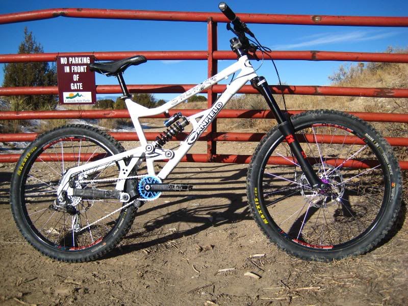

    New addition to the Balance
    Or maybe it'd be a subtraction...
    28T BlkMrkt Revolver

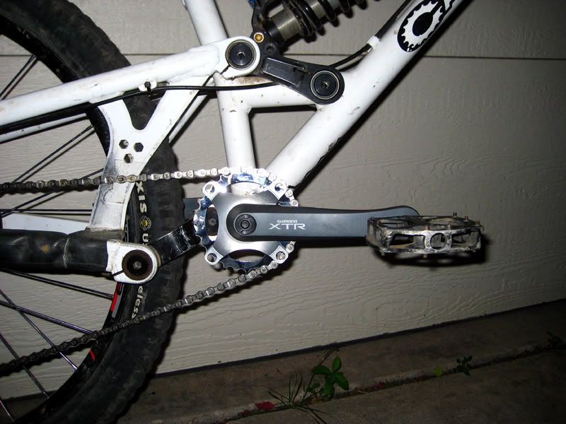

    The logic behind the madness:
    So far it's great. The 1x9 fixed my chainline issues, I no longer rub the vertical, drive side support on the rear triangle, and I only dropped a little over two gears off either side of what my 2x9 provided. Not too shabby. The climbs hurt a little more, but my chainline couldn't be better in my primary, technical gears. I'm pleasantly surprised.
    I think the future holds a custom fixed bash guard/guide that mounts to the spindle and is positioned by the ISCG tabs. In addition, I'll probably get a 32T to swap in on Keystone days. We'll see.

    Very nice! I'm almost ready to do the same basic mod. to mine but with an LG-1. I just haven't gotten myself convinced that the rubbing bugs me more than climbing tech. stuff in that gear...Of course if I could get the 28t AND the LG-1 things would be pretty sweet.

    Nick you rig is hot!!

    The suspension on the Balance feels the best with a 36 tooth up front as it brings the chain closest to the pivot area. Smaller will give you the pedal feedback that I have learned to deal with on my small ring but never enjoy. Being able to shift up to the larger ring means I can get rid of most if not all the pedal kickback when descending, has that been an issue for you?
    Also, after a month or two of a LOT of xc rides, I rubbed enough material out of that vertical support that the chain no longer makes contact. It became a non-issue.

    Thats a pretty cool idea and a really sweet looking setup Nickle. I spent the entire last season beating my self up with a 32t single. Around the Wasatch front there's a ton of climbing, a 28t would have been welcome. Good work!

    Old thread, I know, but I'm rebuilding my Balance right now and the chain rubbing thing is something I'm trying to fix.
    Nickle, you said this has solved the problem for you. I'm curious, what were some of the other things you first tried that didn't work? I assume you tried spacers on the BB.
    I really want to keep two rings up front, but this rubbing is annoying. Any ideas other than going single ring?
    1,197
    if you want two rings, it will rub for a bit
    On mine, I eventually rubbed out enough material that it stopped. If you space it out too far, you mess up your chainline and start dropping the chain. You could find something to protect the metal but it will still rub, I just accepted it and moved on.

    Do you think one spacer would be too much? I have been putting a piece of tape where it rubs, but it just rubs off almost instantly. Did you actually end up rubbing material off, or just paint off the frame?
    1,197
    Hard to say how one spacer will affect it
    Try it, see if it is dropping the chain to the bottom ring in rough stuff. Could also affect your ability to set up the front deraileur correctly. You can always give it a go and remove it if issues crop up.
    It actually carved into the aluminum, took out material beyond paint. Only a couple of weeks tops and it was silent. I have a noticeable groove in that vertical support but does not seem to matter beyond aesthetics.
    The MRP Bones setup that I posted above did fix my chainline and rubbing issues, but those cranks caused me a lot of heartburn and have has since been scrapped. The [only] good thing about them were that they were 3-piece BMX style anvils. I could space the chainwheel with relative precision and ended up centering its plane on the cassette. The chain just cleared that vertical support with it setup like this.
    My new 1x9 is a far better and lighter setup and pulled the chain ring in a bit more. I did rub again and my chainline isn't as good in the little cogs as it was the MRP Bones, but it's tolerable. I ended up lightly filing the vertical support to reduce the significance of the rubbing. I figured the chain would do it over time anyway, so why not save some wear on the chain and use the right tool for the job. I don't have many pics of the new M952 XTR setup, but this at least shows the light filing job. The e.13 STP and trials bash guard that mounts to the middle ring position should be here this week.
    Overall, my impression of the Balance as a 1x9 trail bike is extremely positive. Much more so than a traditional 2x9, which I ran before with poor results. If anyone is considering performing a 28T 1x9, let me know as I have "dos" and "don'ts" to share.

    Nickle, thanks for the info. I'm using XT cranks, so I imagine I'll have similar chainline/rubbing to your XTRs. I could switch to a single ring setup, I have a 36 tooth chainring here, but the climbs would be brutal. I might possibly try a 28T or even a 30T.
    tls36: It appears the only way to get past the rubbing issue is to let it rub until the material is gone. Pretty crappy solution, but I guess it's a small price to pay. I'm really happy with this bike otherwise.
    Your retarded
    Reputation: Nickle's Avatar
    3,085
    Quote Originally Posted by fuzzynutz
    Something I should note about my new M952 XTR setup is that I'm using a 116mm spindle BB instead of the typical 112.5mm spindle BB. I'm doing this because the eNVy 28T chain ring is designed to be mounted in the 64mm BCD granny ring position. Even then, I had to use a single thin spacer on drive side to get the chainline correct. I'm not too excited about that, but everything seems to be holding up so far. This is already a far better setup than the Bones/chainwheel setup was.
    If you were going to try something similar with a modern 2-piece, integrated spindle MTB crank, I'd do it with a crank designed for a 83mm BB shell and use a 73mm BB in conjunction with it. I'd then use spacers on the spindle between the BB cups and crank arms to achive the correct chainline. Or, bight the bullet and have a machinist resurface the chain ring mounting surface of your cranks so that the granny position is closer to the same plane as the middle ring. If you don't do one of these things and run an eNVy 26T or 28T chainring in the granny position on your stock XT's, you'll likely still rub and your chainline will likely suck.
    Also, as far as I know, there is only one company (their name escapes me) making a 30T 104mm BCD chainring, but it is freaking pricey and made from Titanium. If you find a 30T 104mm BCD chainring that is at all affordable, let me know because I'd buy one in a second.

    Hadn't looked at this in a while but I did find a decent solution to the rubbing issue. I have some heavy duty PVC that I got from my old job (it's the outer casing for a large, direct burial phone cable) which is very durable. I cut out a small section and attached it to the rub area with liquid nails (I also beveled the edges so the chain doesn't grab). I've had it on for several weeks now and it's working great. I have plenty of this stuff if anyone wants a piece. The thickness is only 2.5mm BTW.
