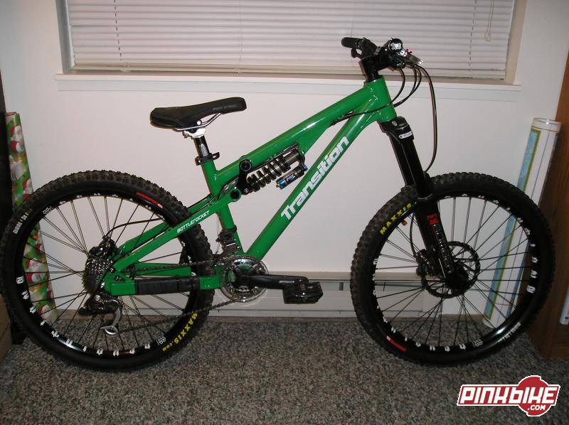

    Here is my newly built Dirtbag, weighing in at 45.5 pounds (not one single part chosen with any consideration for weight saving):
    And here is my wife's BottleRocket, weighing in at 40 pounds:
    She chose her bike for general downhill and freeriding because the small Dirtbag's standover was too tall for her stature (5' 4"). She loves it, but says it's a hard pedal for trail riding (compared to her Kona Dawg). I chose mine as a more freeride oriented replacement for my Yakuza Kumicho DH bike, and even with a single 38t ring on the front it pedals suprisingly well (with the SPV in the Swinger set up correctly). My first rides on it were last weekend at Black Rock in Oregon on Saturday and SST in Washington on Monday and it handled woodwork very well, with a good tight turning radius,and 4-5 foot drops with a smooth bottomless feel that had me conquering my demons from rides past and trying new stuff that I had previously sworn off of trying. And that's in the first weekend! My wife is having the same level of success with the Bottle Rocket, so really the question is what are you using the bike primarily for (be honest with yourself) and how much travel do you really need (more honesty)? The BR flicks better, the DB is a little more rounded for all around trails and has that extra 1.5" of travel. Both are great bikes!
