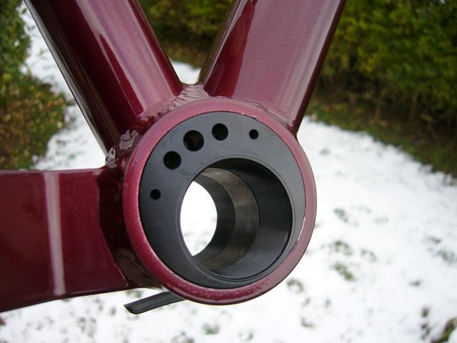

    For the EBB type looks this picture :
    The frame weight is approximatively 4.2 lbs in L size.
