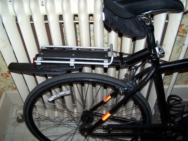

    I run a topeak seat rack with panniers. I will tell you this: The weight limit is 20lbs... I havent really pushed the issue with that too much, but I trust that 20lbs is about all you will want to safely attempt on a post rack, so dont really plan on loading down with a bunch of groceries or carrying 1000$ in pennies or anything like that . I use mine for fairly light loads of clothes or a couple books, but never anything too crazy. The beam rack is extremely stable and stiff though and does not flex one bit. It feels like a traditionally mounted rack and the clamp has worked excellent for me so far.
    Also: the rack works excellent overall and I have had zero issues. I frequently use it with a topeak trunk bag in the summer as well and I couldnt be more happy with the setup. The only problem is that being a seat post rack, you will have movement occasionally no matter how tight you have it on there. If you lean it up against something it may move from center a little bit. This is not really an issue unless you use the fender on the bottom of the rack like I do and in that case if you dont check the rack alignment you can end up getting wet.
    Here is what mine looks like:
    I rest the clamp actually on the seat collar itself and it sits fairly low with only a few inches to spare from the top of the tire.
