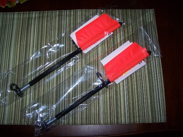

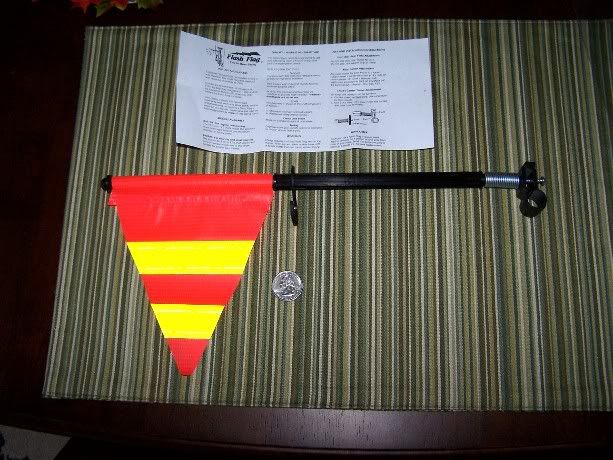

    The flags I received were professionally shrink wrapped and seem to be fairly durable. They are also visible enough with two reflective strips on them.
    (quarter shown for size reference) The one complaint I have is that the flags seem a little small. Reading the instructions it seems that there are two flavors of these flags, one "road bike" flag which is 13" in length, and another "commuter flag" which is 17" in length. The flags that I received were the smaller ones, but with the difficulty in finding these stateside I guess beggars cant be choosers.

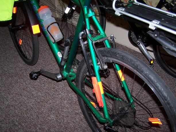

    The bracket that mounts the flag is another sour spot from what I had read- so I expected fitment issues. The bracket is basically made for the tiny road or touring bike tubes that are becoming increasingly unpopular amongst cyclemakers. Ian from the blog where I bought these offers an ingenious solution of using the original set-screw and running it through a hose clamp in order to make them fit on larger tubes, but I had a better idea in mind. I should also note, that while mocked up I was able to pedal like normal and had no interference with the flag. once in a while when I went to dismount the flag would hit the rear of my left leg while I put my foot down but nothing while riding the bike itself.

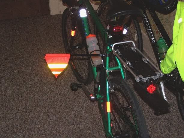

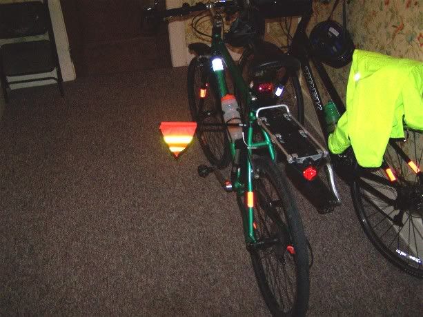

    Here is the flag mocked up the way it is designed to fit on most regular bikes:
    the flag also features a neat hook, that allows you to clip it down and out of the way when it is not needed:

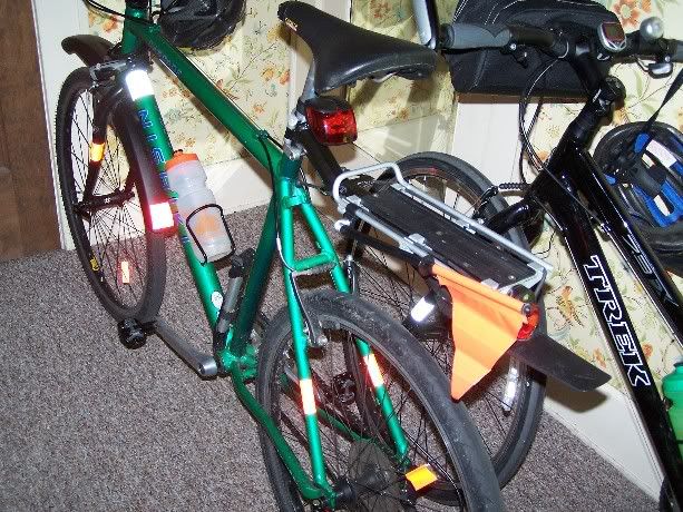

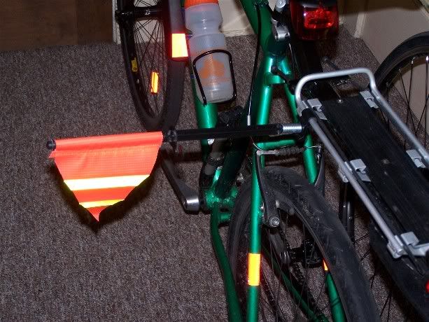

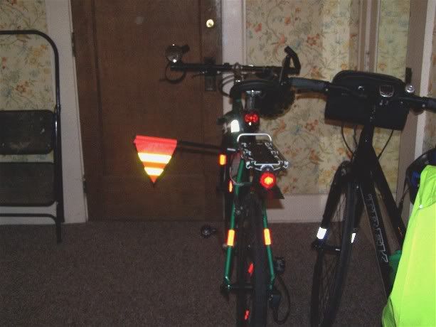

    I opted to mount my flag on my Topeak rear rack (which serves as my fender). I took some electrical tape and taped the area on the rack rail to mount the flag to, then with a piece of rubber from some other bike accessory, made a shim for the clamp. This mounting also projects the flag out further away from the bike, and keeps it better out of the way. It also mounts it higher for better rear visibility.

    Ok, I have some riding experiences to share with this flag installed.
    First the good: Its basically unnoticeable as a rider. I had no idea it was back there most of the time, no annoying sounds, no noticeable drag even in some pretty hard gusts of wind. I took it on a 25 mile ride yesterday and it seemed to work just fine, no issues or failures.
    The bad: This flag doesn't work like it is intended due to physics. While riding over 15 MPH, the flag is in one position, and that is completely horizontal. It doesn't really flap because the material is too thick and the flag is too small, it just sort of rides horizontal due to the wind. This is a major issue for visibility IMO, and while I tested it out and could SEE the flag while it was in this position, it is not as effective as it could be. I have thought of a couple ways to possibly fix this, but it seems the best approach is not to use a flag at all, but perhaps a pinwheel type device or just a solid sign (with air holes cut in it) similar to what they use in nascar, that simply cannot go horizontal while riding.
    The overall results, despite the flaw in the design is positive. I seemed to get plenty of room out on my country road rides with it installed. I cant credit all of this to the flag, as I wore my typical hi-vis stuff as well, but I didn't have any close calls while using the flag. It also seems to work well in more urban areas too, and I can attribute that to perhaps the slower speeds and the more frequent stops making the flag more visible.
    In short... it needs some design work IMO and it doesn't look nearly as noticeable when you are actually riding due to the position that it rides in. I think this may have contributed to the bad results that the triathlete had with the flag, especially if they were really cranking down the road.
