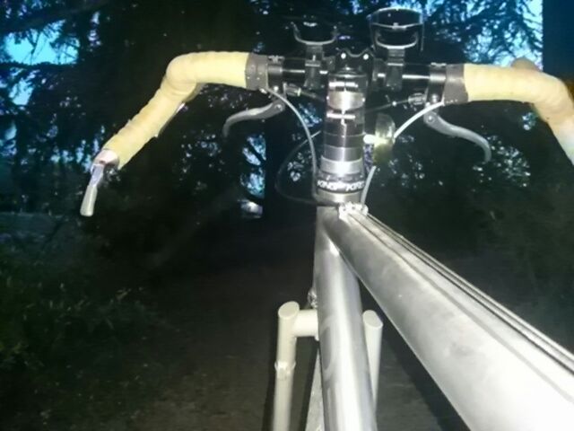

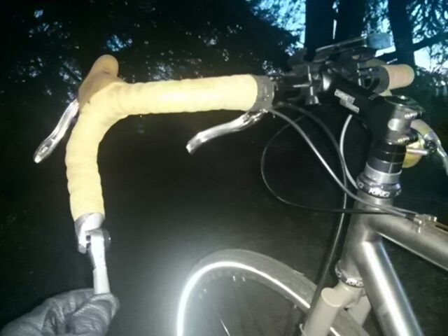

    photos of my Midge set up
    Here are some photos I took this evening. I actually wimped out and drove to work today, and when I saw your email from this thread, I had to go out and take pics, and of course sneak in a twilight ride. So thanks for the inspiration. I've been riding single speed on the dirt so much, it was a real treat.
    Of course these photos are poor, but at least you get an idea. I was in a hurry. A photo from in front of the bike might be helpful, but I didn't get one.
    While I wait for a couple more snapshots to upload - more comments.
    The ride started on street, then went along some railroad track-side. Along the tracks it's a good flat gravel grind. I was in the drops for this part, and very comfortable. My Conti Touring Plus 32mm tires were probably at 60 psi.
    The bike has a triple, with a low gear obtained with a 24t and a 32t, so it can pretty well go mountain biking. As well, it sports cross-top brake levers.
    Looking at it from the side, I was surprised at how closely the angle of the drops is to the down tube of the bike. This was not intentional in the set-up. Never noticed it before. The configuration we see here is the result of a lot of tweaking over time. It settled here, and has not been changed for more than a year.
    Yes, I've had the bar for a long time, but it wasn't until I got the current stem/spacer combination that I became satisfied. At first I tried stems that were high rise. Not only did it look whacked, but I didn't like it.
    I should probably get a Midge in 31.8 since the stem I have is 31.8 with a shim. Objection is white bars only available at the mo.
    The Cane Creek levers work great and were reasonably priced. I picked the gum look - posed "classic-retro".
    The hoods I have mounted very high up...I was aiming at horizontal. I had the bars rotated a bit lower originally, but on some extended uber-bumpy single track descent the bar rotated lower in the stem clamp once (around the shim) and I cinched it up at the end of the trail, adjusting it up, and higher, because I realized then that I wanted the hoods to be slightly angled up so that I did not feel like my hand was going to slip off the top of the hoods if I hit hard somewhere.
    The brakes work good on the hoods. But also the drops are good. Then if it is really seriously steep and I need to get behind the bike I go to the cross-tops.
    That said, this is no real mountain bike. I can get this bike through any trail that will support the narrow tires (I can run up to 38's in the back and 45 up front), but the set-up requires some real *****-footing around.
    Climbing, the Midges are really wonderful. Later on the ride I got to enjoy a rare long set of steep stacked switchbacks, the steepest at the top, and cleaned it. In the granny, at first I was on the hoods - a good place to get forward on the rivet - and pedaled up fine - then towards the top where it got real steep, without thinking, I went to the drops and all the way to the front, and managed the last three sharp turns in good form.
    However, I think hours of this would probably kink my back.
    Interesting about extending the bars with crutch tips. I do think the bars are fine in length with the bar-con shifters adding a half an inch, but without that I'd be a hater.
    The Salsa Woodchipper looks nice and long. Not sure about the Soma Junebug.
