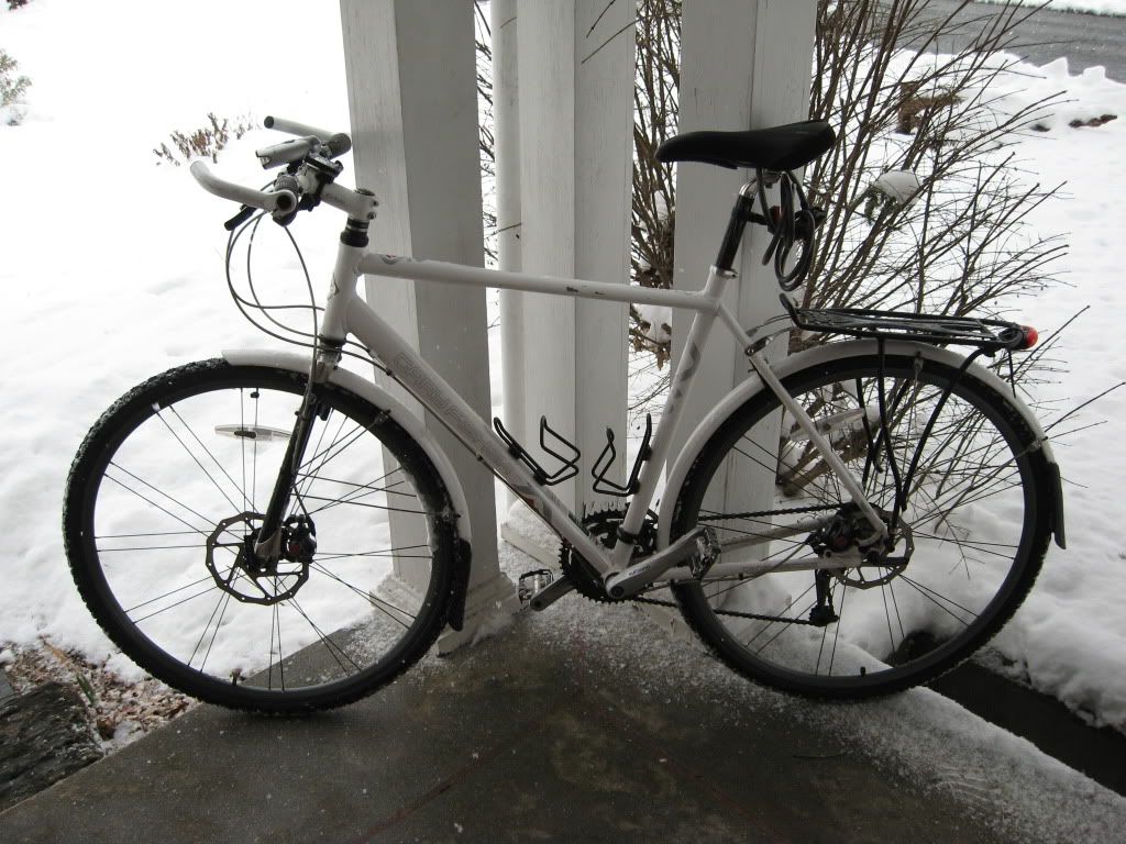

    [QUOTE=moonedzx9]All of the planet bike hybrid fenders say for a 700 x 35. Will they fit? If anyone is running fenders with this size tire what fenders are you running? The tires are serfas vida 700x38. The LBS I go to had my dad drop from a 38 to a 35 to run fenders. The tires I have are brand new though. The lady a planet bike said I might have to order longer stays. She suggested the hybrid fender. I don't really want to buy fenders and have to send the stock stays back to swap them. Thanks for any help ![/QUOT
    I have used larger than suggested tires on two different sets of Planet Bike fenders. The first bike had 700x40 fenders with 700x45 tires. The second bike (pictured) is my current commuter and, it has 700x35 fenders with 700x40 Nokian studded tires. My street tires for the second bike are 700x32. With both bikes the larger tires fit under the fenders. Much to my surprise the fenders on the GF did not need adjustment to clear the Nokians. Most tires aren't as big as they claim plus most fenders will clear a size larger than recommended without a problem. I hope this has helped.
    <a href="http://s291.photobucket.com/albums/ll290/MrIce807/POSTED%20DO%20NOT%20MOVE/POSTED%20Bikes/POSTED%2009%20Mendota/?action=view&amp;current=Bike009.jpg" target="_blank"><img src="http://i291.photobucket.com/albums/ll290/MrIce807/POSTED%20DO%20NOT%20MOVE/POSTED%20Bikes/POSTED%2009%20Mendota/Bike009.jpg" border="0" alt="Photobucket"></a>
    <a href="http://s291.photobucket.com/albums/ll290/MrIce807/POSTED%20DO%20NOT%20MOVE/POSTED%20Bikes/POSTED%2009%20Mendota/?action=view&amp;current=Bike007.jpg" target="_blank"><img src="http://i291.photobucket.com/albums/ll290/MrIce807/POSTED%20DO%20NOT%20MOVE/POSTED%20Bikes/POSTED%2009%20Mendota/Bike007.jpg" border="0" alt="Photobucket"></a>
