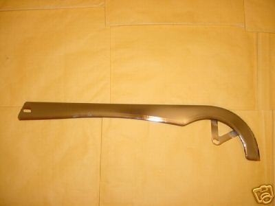

    It's hard to find something like this:
    that doesn't interfere w/ front derailer.
    There are a variety of chain guards for single ring or, best of all, single ring/single cog setups, but adding derailers complicates things. The very best chainguard I've seen is full-enclosure one on my wife's breezer. The Trek L200 had something similar.
    My son's 16" bike had something like on the picture above and it really protected the chain too as well as his pants, 2 school years of bad weather abuse and never had to oil the chain. His 20" bike has one of these things and 3 months into the school year his setup is getting creaky.
