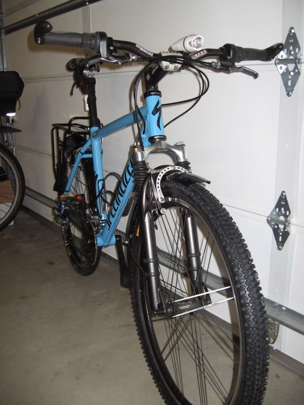

    First decision for the remake was to decide what paint and color to use. I decided to get the frame powder coated at Maas Bros in Livermore because they come highly recommended on this board by locals. Next was the color. I always wanted a blue bike and I decided to pick out a color when I got to the painters. Maas can pretty much powdercoat any color you want. When you walk into their shop, they have two walls of aluminum beer cans painted in all the colors they have available. It's quite a sight. I picked a metallic sky blue and handed over the frame. A week and a half later I picked up a beautifully painted frame powder coated metallic sky blue with a coat of clear. Now a good base to build upon.
    Here's the bike after the re-build:
    While I waited for the frame, I was undecided whether to reuse the old Manitou fork or go with a new rigid. I sorta wanted to go on the cheap on this build and also wanted to test out my DIY painting skills so I repainted the old fork myself. I cleaned and sanded down the fork and hit it with a coat of Duplicolor primer. Then I sprayed it with Duplicolor metallic dark grey to compliment the frame. I think it came out pretty good.
    The Stumpy only had holes in the rear drop out for a rack but no holes on the upper seatstay so finding a rack that would work was the next decision. Google works wonders and after a few clicks of the mouse I found Old Man Mountain. Their Red Rock rack utilizes the v-brake posts in lieu of the missing seatstay mount. A very nice sturdy rack with a 60 lb rating so it'll be enough to go grocery shopping or lugging home a six-pack or two. I also picked up the Planet Bike EZ fenders since the only frame mounts were being used by the rack. It was a pretty simple install and provides full coverage.
    I mounted a Planet Bike Superflash to the seatpost after seeing someone else riding with one. It's a super bright LED and the flashing mode looks like a miniature emergency vehicle light.
    For the front end, I swapped the bars for a carbon Race Face Next riser bar to give me a more upright riding position. The grips are a pair of Ergons with integrated bar ends. Yeah, I know that riser bars and bar ends are a bike fashion faux pas, but fashionistas be damned! I like multiple positions that bar ends provide. The Planet Bike Blaze puts out enough light for my needs when riding at night.

    The PB EZ front fender fit pretty well on the fork. The only thing I need to do is find a way to securely mount the fender to the fork arch. There are two mounting points on the backside of the fork arch that I can use. A trip to the hardware store for some aluminum stock to fab a mount is in order. I picked up a pair of Continental Traffic tires since they were on sale at Performance while I was their picking up new shifter cables. They have a semi-continuous center tread for fast rolling but still have minimal knobs on the side for light off-road excursions.
    The only thing I'm missing for my commuter/grocery getter is a pair of panniers. I think I'm going to go with the Ortleib Back Rollers. Anyone have any suggestions for waterproof panniers that paper grocery bags will fit in?
    Can't wait to commute on my "new" bike.
