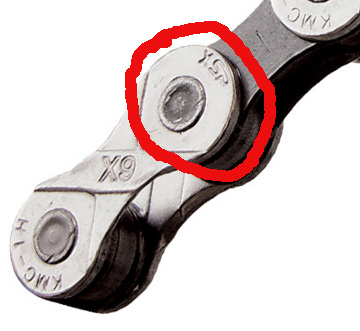

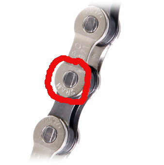

    Some pictures to help
    Quote Originally Posted by tenbsmith
    That's all great info. I snapped chains a few times before I had much technical knowledge, so not sure which brand.
    Being a man of 1,000 questions I have to ask:
    Can describe or point me to a description of how the pins differ or explain a "center punch pin" and what SRAM uses?
    I did a little googling and couldn't find it.
    OK, lets start off with SRAM. They use a pin system that came from their aquisition of the bicycle division of Sachs. It works very well with the thick side plates of 7 and 8 speed chains. However, 9 speed chains have the same internal width but have to be narrower so the side plates are what got thinner. Pin strength is now extremely important. Their standard pins are rated to 200 kilo's pull strength. Plenty for standard conditions under standard riders...but combine bigger riders and the occasion ill timed shift and IME, they're not up to par. Look at the picture, the strength of the pin is perpendicular with the chainline, but not uniform around the entire pin. I've actually taken several chains apart and the SRAM is only gripping the plate on each side of the center ridge.
    Knowing this shortcoming, SRAM makes the PC 991 CrossStep (which offers no other performance benefits to the PC 951, 971, or standard 991). This increases the pin pull strength to 250 kilo's but its still not uniform strength around the entire pin.
    Now look at the KMC X9 and the Shimano HG73 (made by KMC), the pin is center punched and flared evenly around the entire pin. This make the strength of the pin uniform and gives it a pull strength of 350 kilo's
    The weakness is if you push a pin out and then push it back in, you've flared the side plate and you have a weak spot. This is what the OP did on his HG53 and probably the spot it failed. I don't even like to use the Shimano supplied pin, I use a quick link. I've used a SRAM, KMC (which looks identical to SRAM's) and Connex (probably the strongest) link with Shimano and KMC chains with no issue. KMC chains come with their quick link so if you go that route your covered. I also recommend carrying an extra quick link so if you do break a chain on the trail, repairing with a quick link is stronger than re-using a pin.
    I'm not advocating you go an ditch a new SRAM chain, and as mentioned before I am a big SRAM user on other parts of my bike. But if your going to spend money on a new chain, don't you want the strongest one for your money...especially if your a Clyde?
